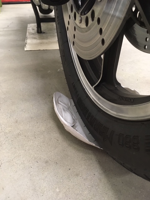

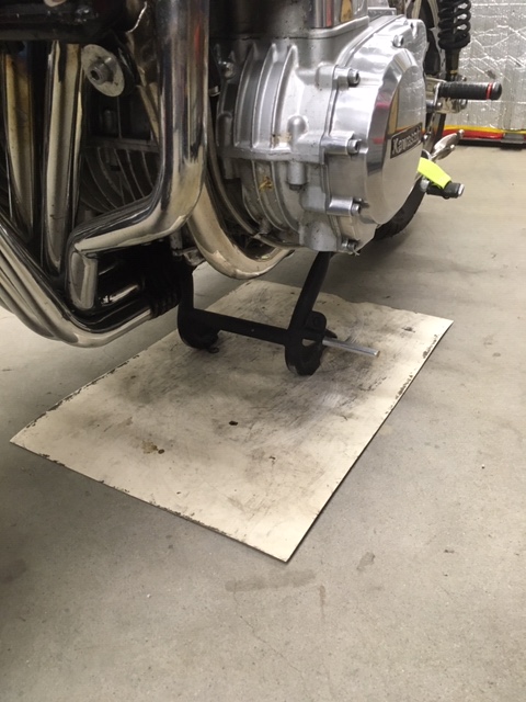

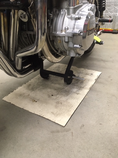

I have found this really handy in my 10X25 shop. I often find that it's convenient to turn the bike around to work on it.
A piece of Arborite (Formica) under the center-stand and the side of a heavy plastic bottle under the front wheel allows me to spin the bike around with ease.
