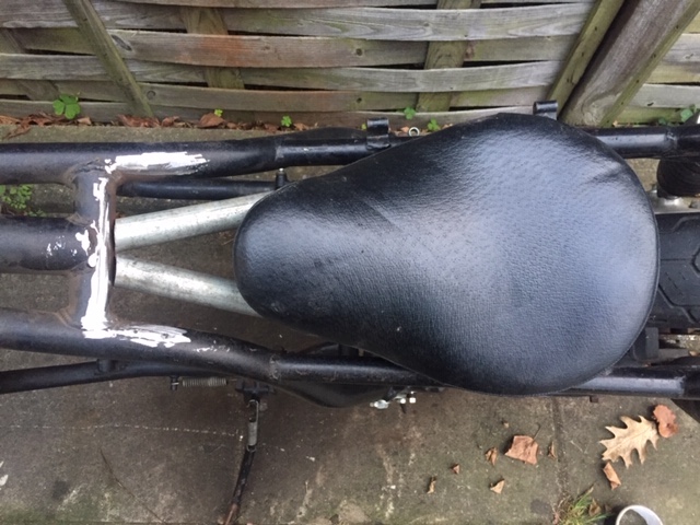

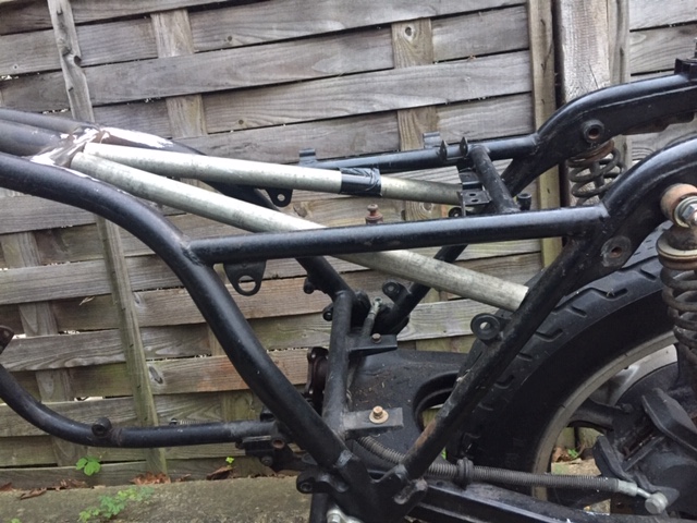

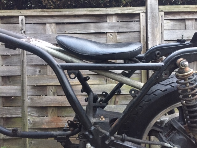

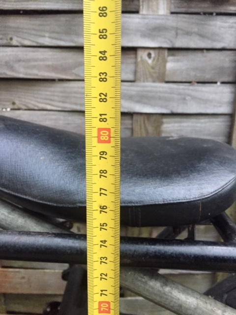

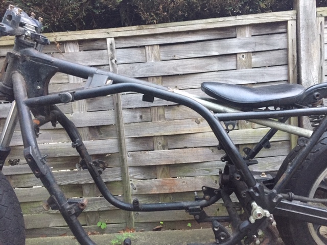

Ok, this is not standard (and if you are a KZ1300 purist, please do not look!), but hereunder a mock-up of my plan.
The horizontal braces will be cut away and the rear verticals will be linked together with a hoop behind the seat. The seat will sit on top of the two new cross sections. The seat height will then (for me) be perfect and same as my KZ1000P.
