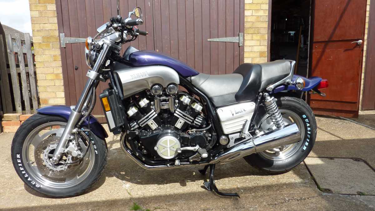

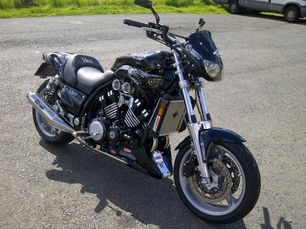

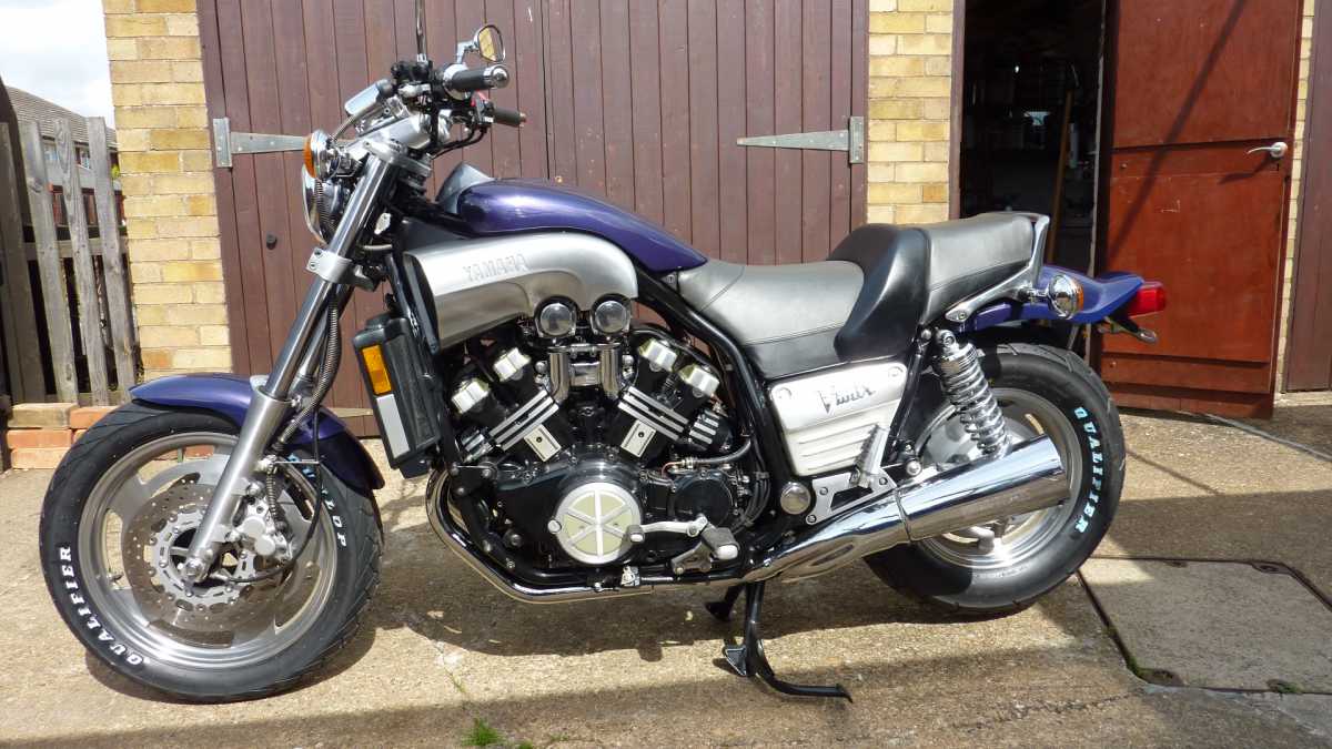

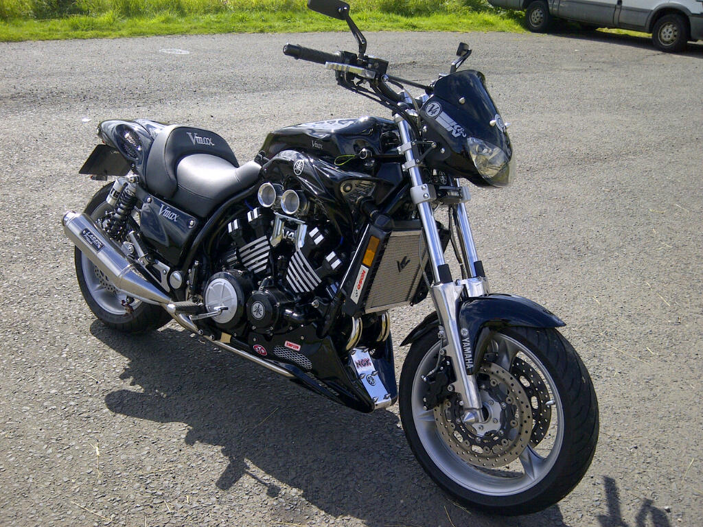

Ive not been able to run my Zed13 for a couple of months due to her being sick - Ive actually been running around on my latest resto project a Vmax1200
Been impressed with this bike: really lovely engine.
