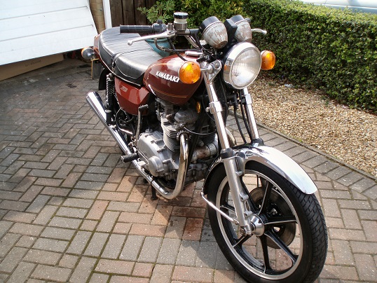

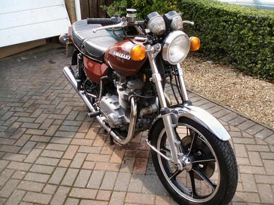

Hi Aerialo,
Just noticed that you've got a sibling to one of my Kaws in your stable.
Yours:
Mine:

Hi.
After restoring the Z1300 and as you do. Needed another project. So purchased the Z750. On going project and hope it turns out as well as yours. Rear end sorted and working my way forward.
Purchased the bike and been stored and not been given the service that required, major problem being the brake callipers. rear sorted, but on the look out for a good front calliper.
Had the carbs sorted and runs fine. Just need to pull my finger out and carry on with the restoration. Bonus being the electric start works. Does yours?

Hello AERIALO, ......I got a kick out of your question ending your post...."my starter works,does yours ?" Back in the 70's and 80's when I worked as a tech at the local KAW shop.... the 750 twin was a ever present bike up on the air lift for "starter" repair;
I recall that 9 out of 10 times the starter was not the problem , but it was always the 3 allen screws on the back side of the starter clutch that had backed out and are found to be gouging themselves into other places till the starter stops working....engine turns over hard....and the starter clutch is damaged. After the new parts were obtained, a generous dose of red loc-tight was applied to those same (but new) allen screws ......and after re-assembly and returned to the customer, we never saw one back for that problem again ! something to keep in mind for the future !.........................tony :
After getting my 1300 done ...I started restoring this 85".....but I must admit, I have been really dragging my feet on this project as well. that "arctic blast "that we just went thru .kinda took the wind out of my sails ! but I will get going on it again very soon.
