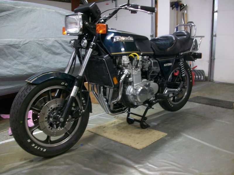

First start today since installing the brass floats and setting the wet float level. While I was at it I replaced the 110 mains with 105's. The fuel level in all 3 carbs was too high previously using the stock floats and measuring them dry. It started right up and ran perfectly! So now this is my setup with the DG 6 into 1 pipe. 42.5 pilot jets, 105 main jets, air screws 3 1/4 turns out, jet needle raised one notch (lowered clip). Seems to work good. Thanks Scotch for the floats. Well worth it!!

11 years 8 months agofastpapaw wrote: First start today since installing the brass floats and setting the wet float level. While I was at it I replaced the 110 mains with 105's. The fuel level in all 3 carbs was too high previously using the stock floats and measuring them dry. It started right up and ran perfectly! So now this is my setup with the DG 6 into 1 pipe. 42.5 pilot jets, 105 main jets, air screws 3 1/4 turns out, jet needle raised one notch (lowered clip). Seems to work good. Thanks Scotch for the floats. Well worth it!!
Hi FPP,
I'm also working with a DG pipe. I currently have 96s as mains and I'm running in the sixth notch on the needles. Before spring I plan to change the mains to 100s and move the the third notch on the needles. 42.5 pilot jet is the stock jet. When you say you lowered the clip I'm thinking you mean to the forth notch. Am I correct?

Correct, 4th from the top.

According to DynoJet, the DG pipe wants smaller jets. The stock jets are 110s, DynoJet recommends 96s to start but also provided 100s in my kit.
