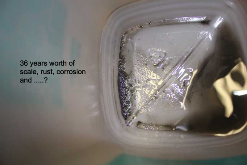

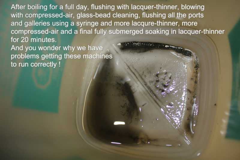

This surprised me. Some thing to think about when you believe you've cleaned your carburetor bodies:
NOTE: The seals on the throttle shaft ends could be damaged if soaked excessively in strong cleaners such as lacquer-thinner. The use of lacquer-thinner for manual surface cleaning and gallery flushing using a syringe is OK.
