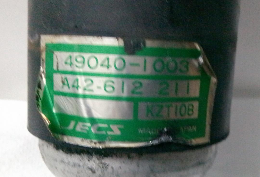

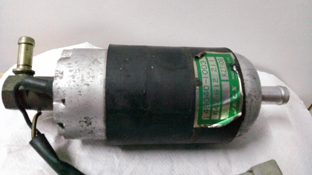

I'd like to stay as close to the original design specs as possible unfortunately I haven't been able to find any specs for that JECS ZNT 30A fuel pump, the OEM pump.
I'm wondering if, given that the system runs between 33 and 36 PSI, a pump that's rated at 70 something pounds is appropriate. Seems like that much pressure difference is just going to agitate the fuel in the tank as the excess pressure is constantly vented.
Thanks
