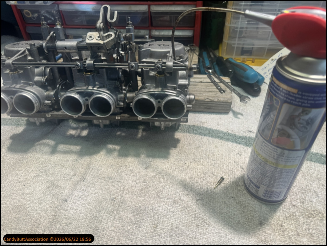

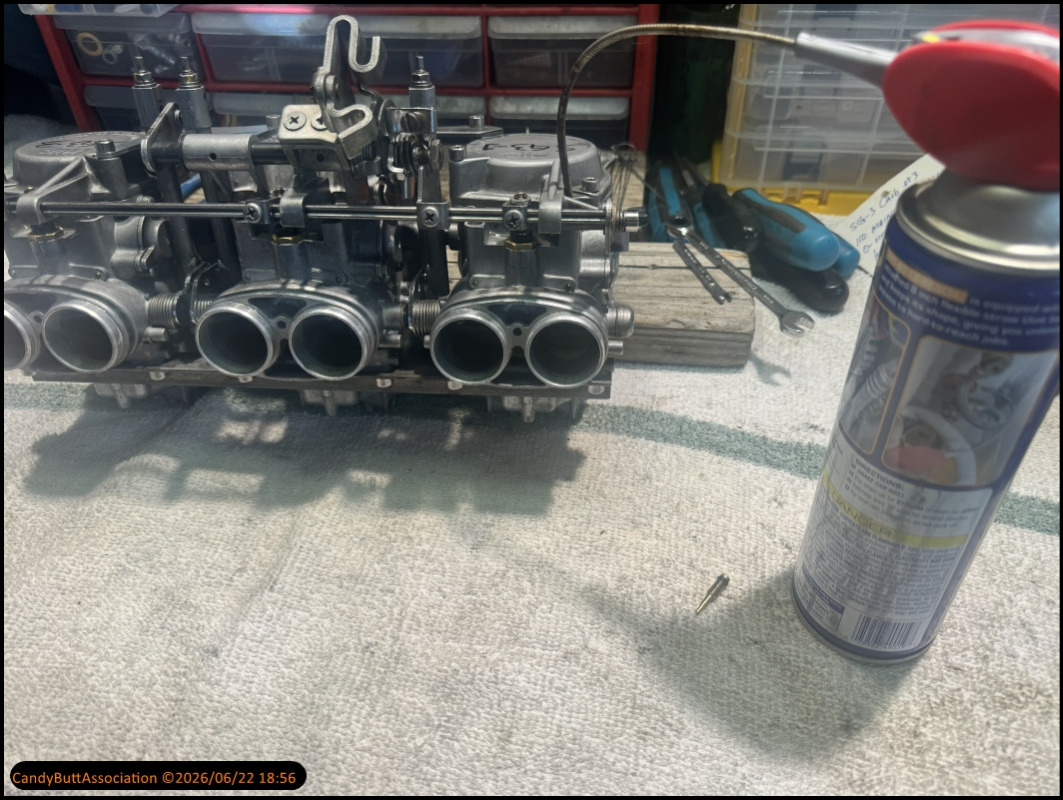

A simple way to determine if the passageway from idle adust needle valve is open to venturi port.
Remove idle jet.
Spring can remain in place.
