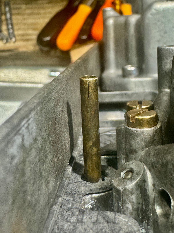

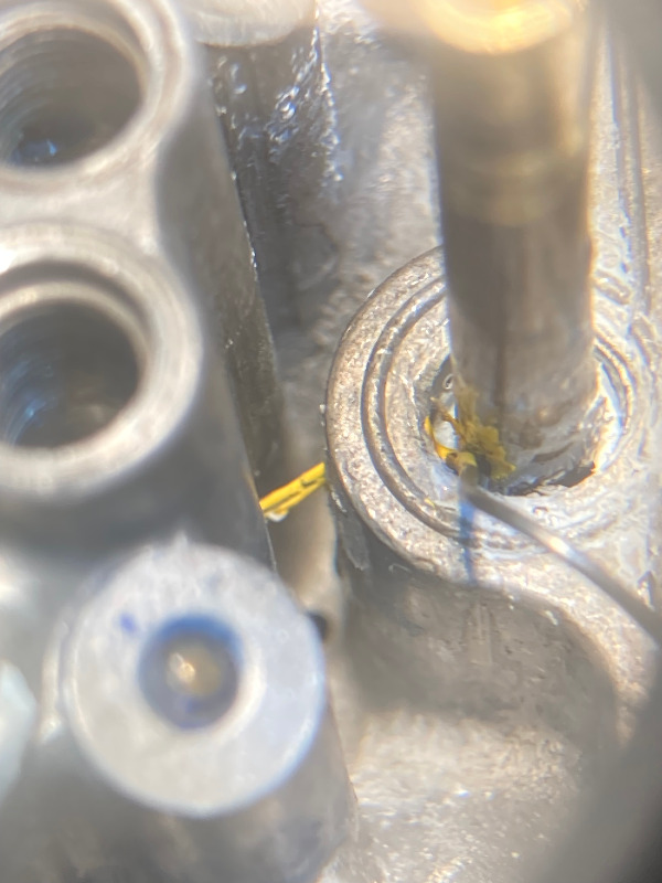

In search of a 3mm brass tube 'cap'.
One of my eBay carbs has crack on the brass choke plunger tube.
Did research from here, apparently a 3mm ID brass tube will 'sleeve' it.
But the restrictor jet is missing,Scotch had a post saying it was 0.010" ID
So looking for a 3mm ID cap that can be be soldered on then drilled to0.010".
Found this post from KB that says .020
Been looking all day, no luck.
Did find this..
www.leathercordusa.com/product/S6003AB.h...XLtkOndUAM4YgUglVLTJ
which could be brazed and drilled.
Any other ideas?
D
Did find this..
Any other ideas?
D

It's .030" / .77mm

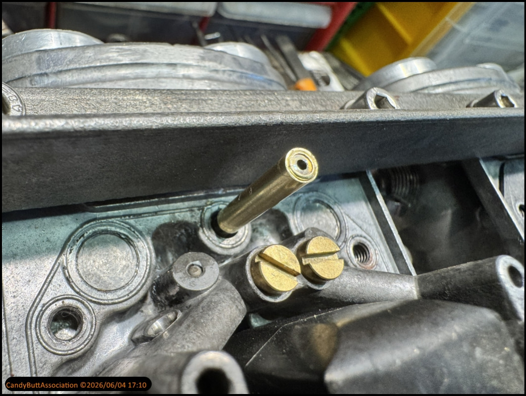

3mm brass tube 'cap'Seems quite viable !

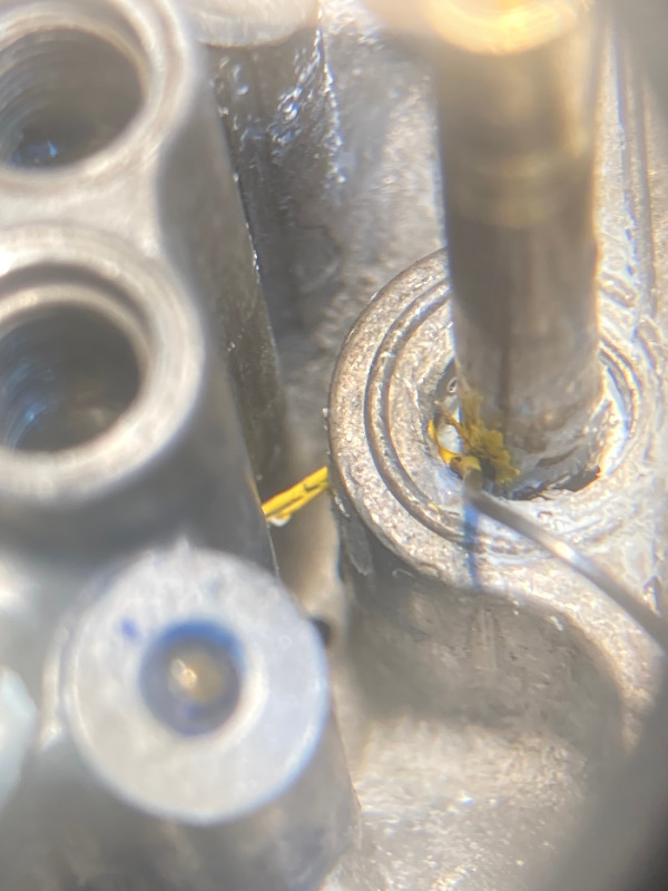

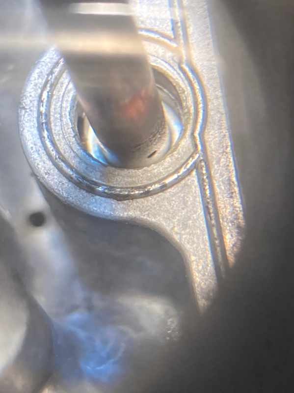

When "sleeving" a cracked choke fuel tube make certain to NOT make the sleeve so long that it covers the air-port at the top of the pick-up !
Not to be confused with the "vent" , also in this area.

Didn't know it existed! Thanks for Info Scotch.
I was lucky this time. Like they say, better lucky than good?
