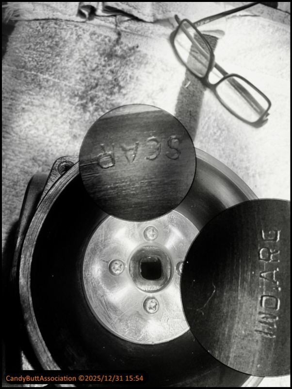

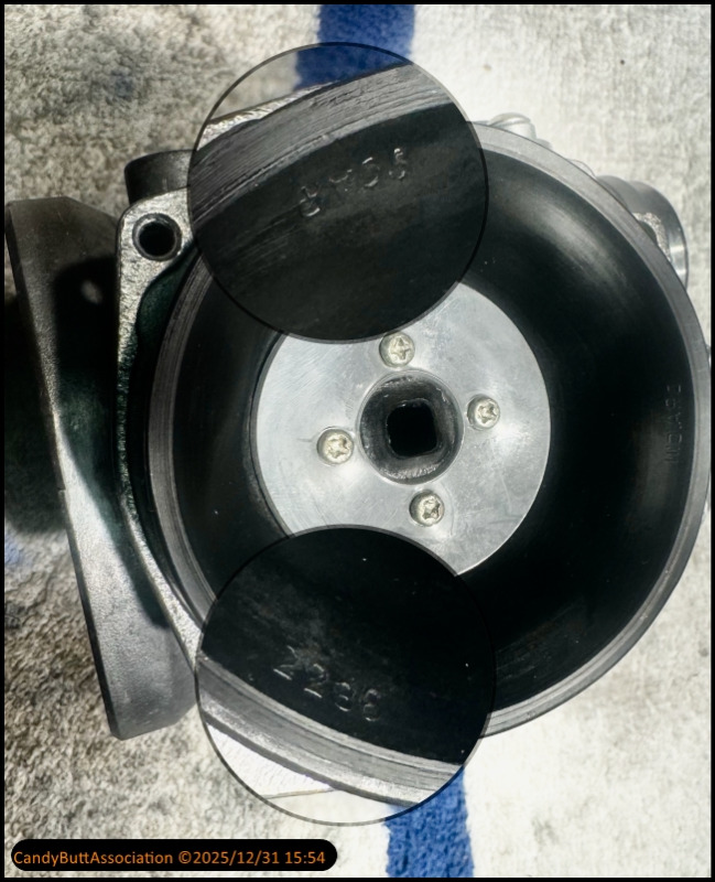

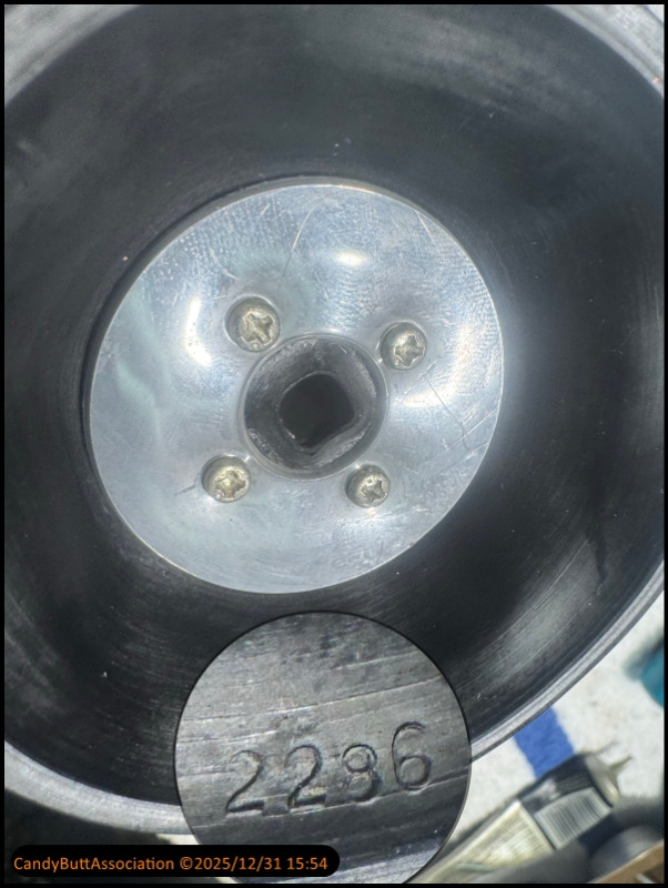

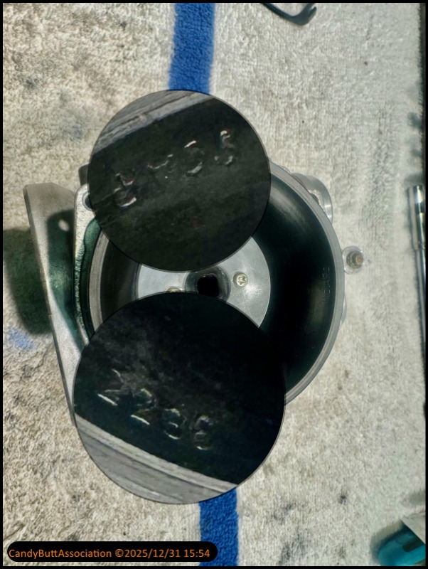

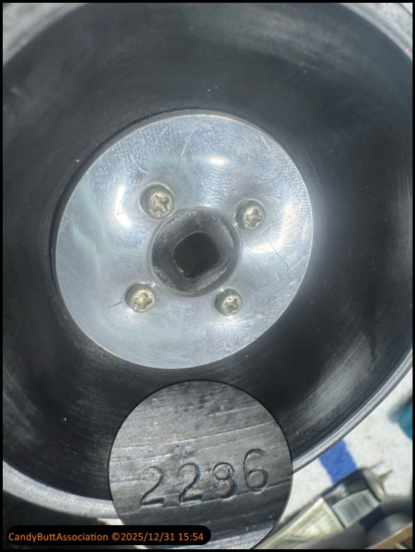

Check this out.
Some markings. Not sure what they mean.
But these are way too stiff.
recall KawBoy from Kz1300.com mentioning he had some stiffies too.
I'd not seen any of the other diaphragms I had beeing too stiff..
Until now.
Wonder if anyone has a clue who sold these..
So as to not buy!
Until now.
So as to not buy!

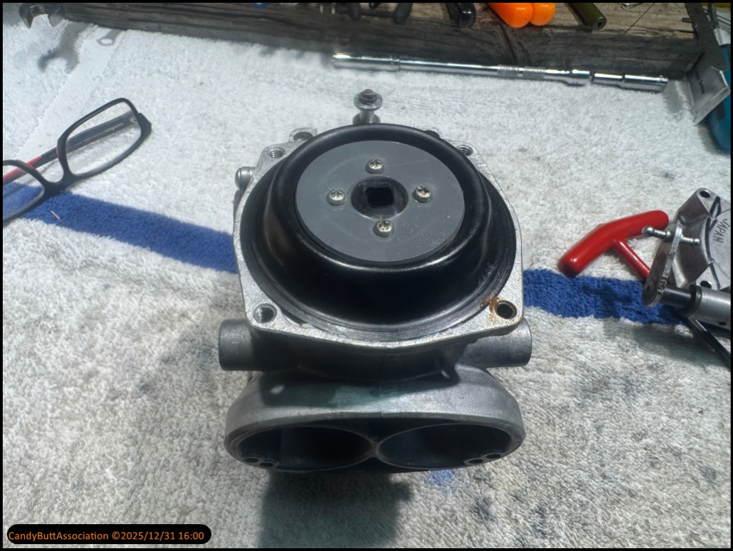

I just ran across this tonight... Any chance the diaphragm was 'upside down' as i found on this one tonight?
candybuttorg.ipage.com/cba/comment/1355#comment-1355
Re: Way too Stiff Carb Diaphragms
9 months 1 week ago - 9 months 1 week ago

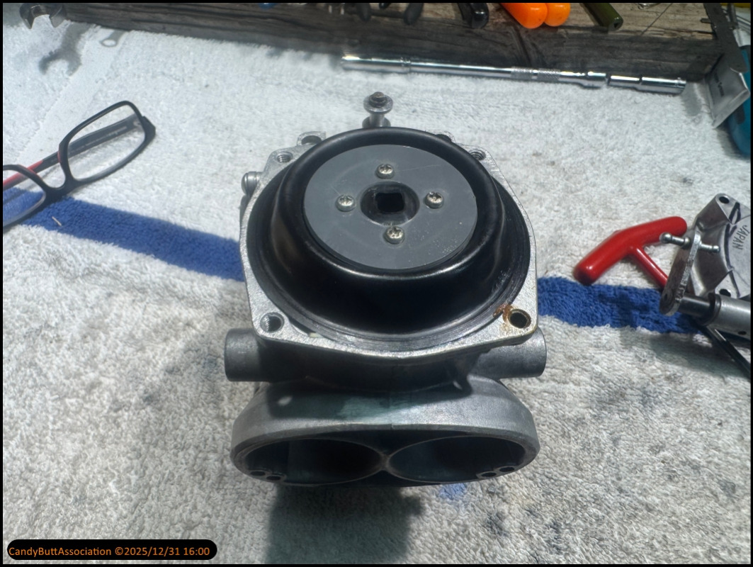

As for the question- Everything about the diaphragm was correct except that when they punched the 4 holes to mount the diaphragm to the throttle plunger, they punched off clock by about 20 degrees.
And No, they were not upside down. There's a sealing ridge on the one side that engages with the carb body groove. There are many reports on the web talking about the fact that these diaphragms from this supplier had this problem and THEY came up with the resolve to just remove the tab and install. Works just fine.
When you hold the carb up side down, the throttle plungers fall open, then when you flip them over right side up, the throttle plungers fall closed. That's how I check them to ensure there's no binding.
One could argue that it's just as easy to open the plungers with your finger and if they fall under gravity, they're good but how much pressure did it take to lift them? Gravity is my answer and I'm sticking to it.
