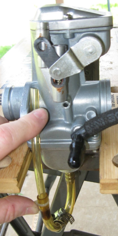

I like to live dangerously! That's why I have two wood-burning stoves in my shop a glass jar with 1.85 quarts of gasoline in it, working on a workbench and using authentic fingers!
Made this adapter for 79 carbs..
Haven't figured out how to for later carbs with screw, not a bottom bolt.
