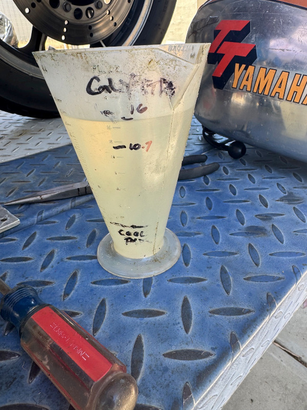

I ran two timed tests yesterday using the smart phone clock and a RatioRite measuring cup.
Test one was with the tank about 25% into Reserve, with the Pingle in reserve position. Here's the result.
~15 Fl Oz in 30 seconds, acceptable. Even good, perhaps, given on Reserve and associated reduced head pressure.
I was all happy n' crap with results, then the thought crossed my cranium scarebellium...
"The Pingle has two separate flow paths, Normal and Reserve. You were on 'Normal' when running at 5k prior to shutting the engine down and pulling plugs for readings."
Acck!
Of course, this was AFTER I already had buttoned everything up, removed bike from lift, placed into trailer for ride today.
Science, of course, requires due diligence so back on the rack for the "normal" test.
This time, the entire Ratio Rite filled to the tippity-top in less than 20 seconds. Way plenty fuel.

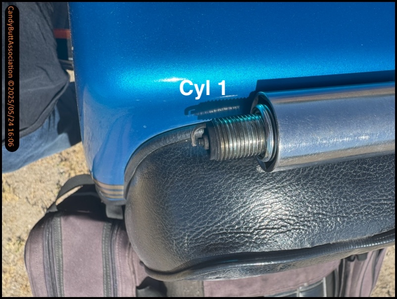

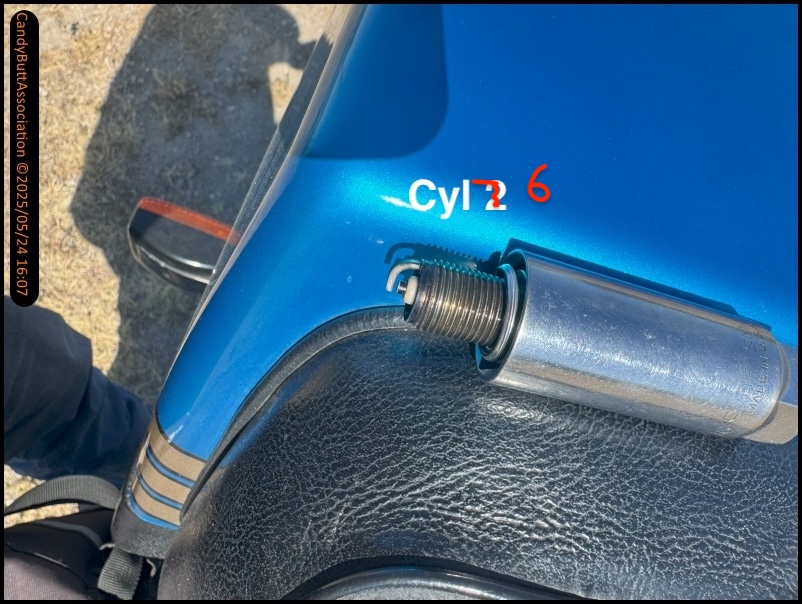

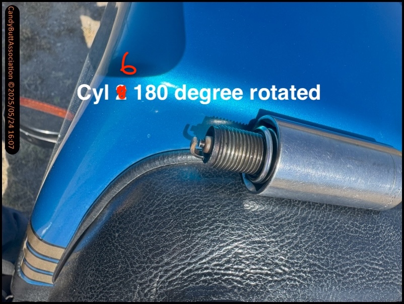

Agree with the bandaid response. Forgot to mention 2 days ago, when performing flow rate test, also checked intake boots for snugness. All appeared to be snug. Did not spray WD-40 or other flammable liquid around the boots to check for leaks. Also checked each of the 6 vacuum ports for snugness. No WD-40 test.
Rode it for almost 200 miles yesterday, paying attention to not press to hard. Yesterday's ride was more about seeing how the bike rode sans the big flat slab of plexi known as a windshield.
Unfortunately, wasn't able to replicate the 5k run, kill switch to off, coast to trailer, pull plugs trick. My favorite public parking spot which enables it had a trespasser. Don't they know who I am?
I need a more scientific l, systematic approach. Establish a baseline via consistent testing. Change one parameter at a time, observe changes.
When it cools down in fall, I'll trailer the KZ out to my favorite long, straight, slightly uphill test road where there is zero traffic save for the occasional cow. I'll go with 3 different carb racks, each one jetted slightly differently than the other.

- Bike starts easily from cold. Just a tad bit of choke, instantly fires. No cranking needed. When fired, she can run off choke at idle with just an occasional hiccup as the engine warms then settles in nicely after only 1 or 2 minutes. To me this indicates the pilot circuit is properly jetted.
- If not 'romping and stomping', the plugs come out much darker. Cylinder one is still leaking a bit of oil into combustion process, but it's tolerable. That tells me the pilot/needle jet circuit is good up to main jet / needle jet transition point. In other words, from 1200 to 4000 rpm, the plugs look normal.
- From 5k and up, on extended durations, the plugs come out white. To me this indicates too small main jet. Additionally, this is 1 overbore engine running DG 6-1 exhaust. Stock air box. Upgraded coils and wires.
