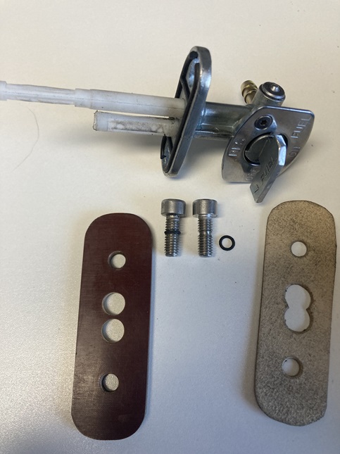

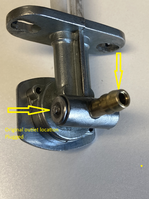

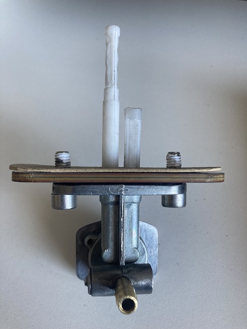

Needing a shut-off and not wanting a "vacuum" valve or a Pingle, I did this.....with a bit of work. for $12.00 !

Looks nice and neat
