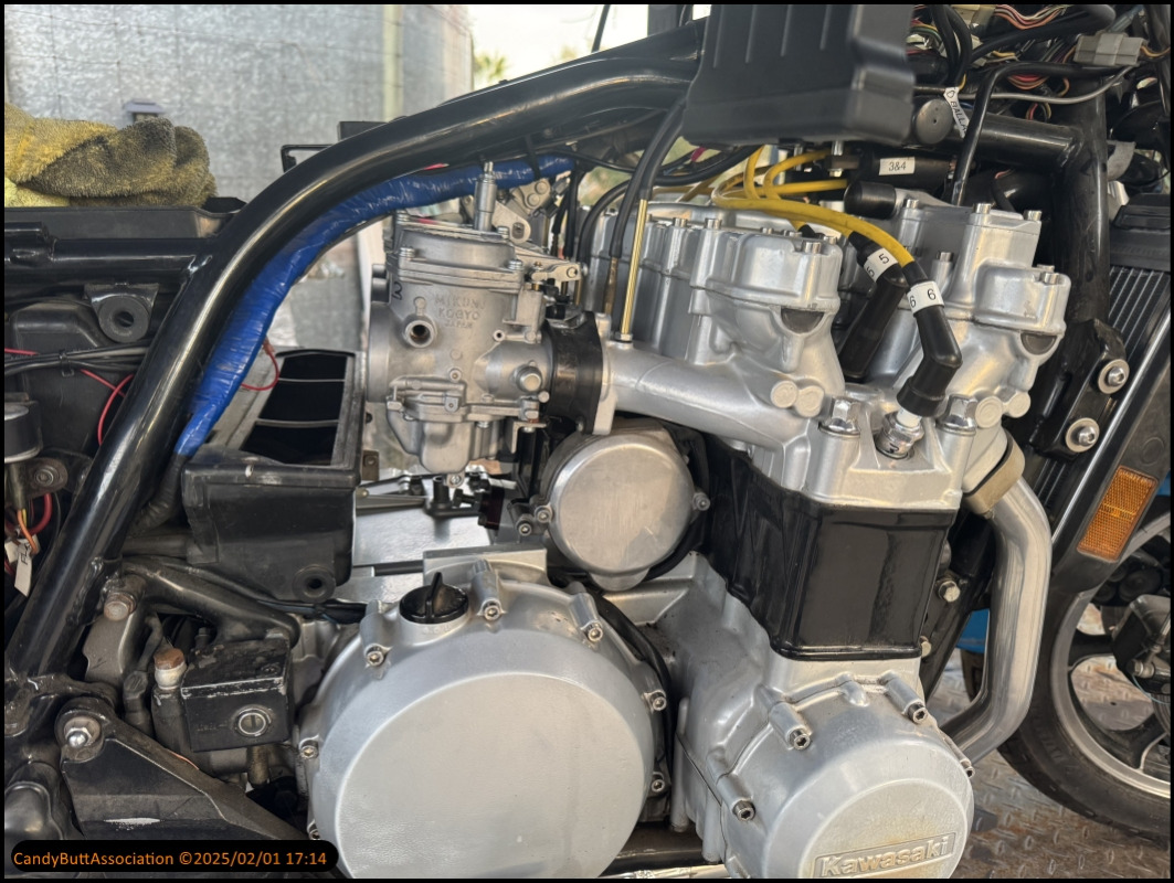

2025-01-31 Install Rebuilt Carbs

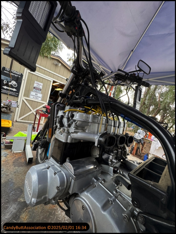

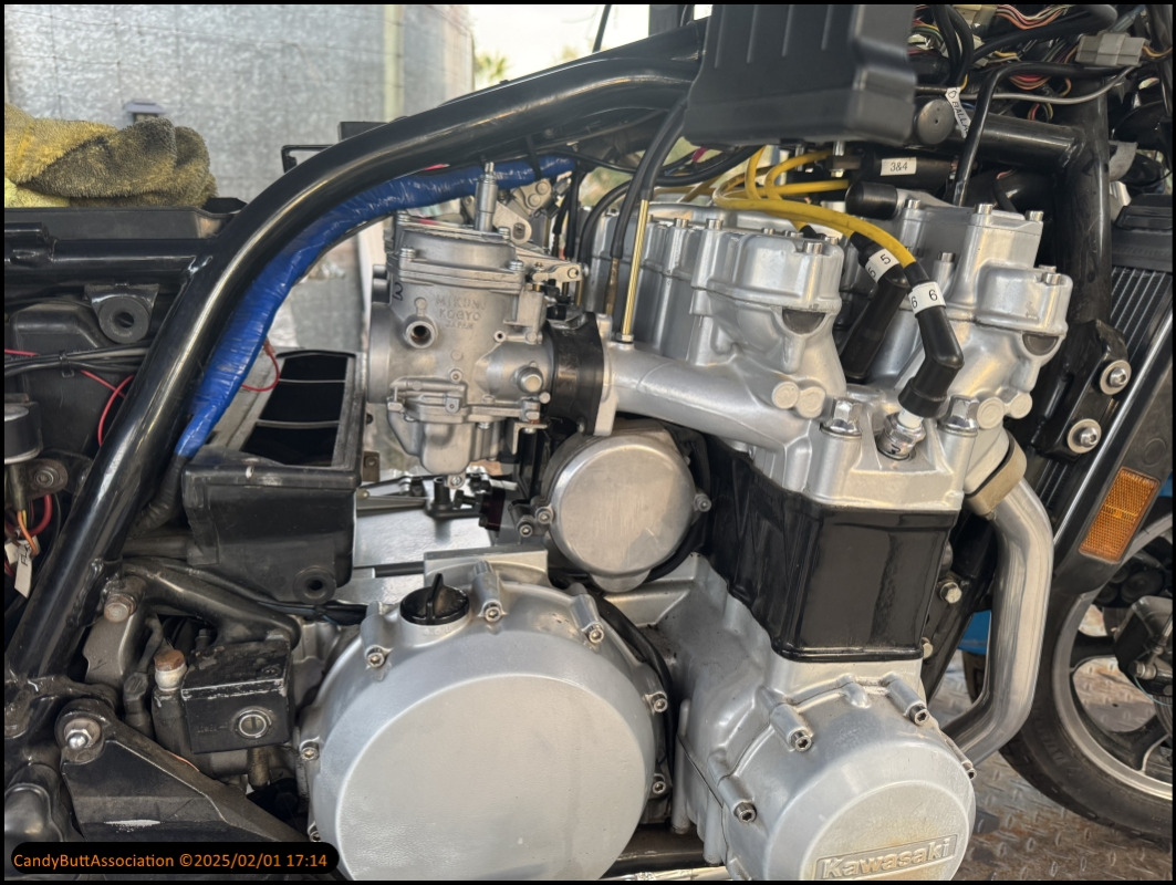

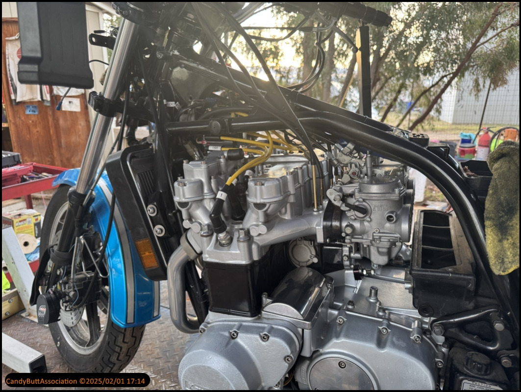

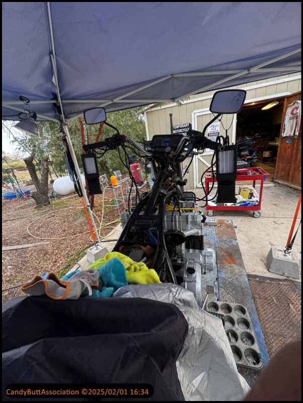

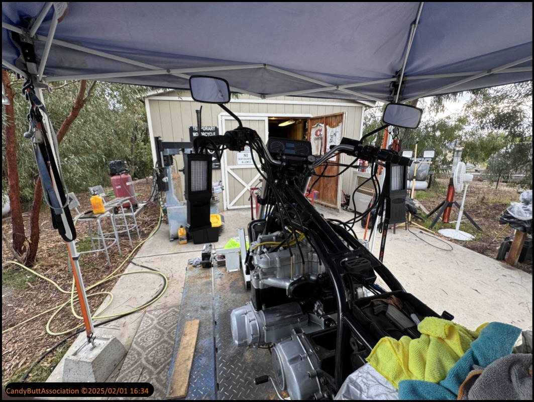

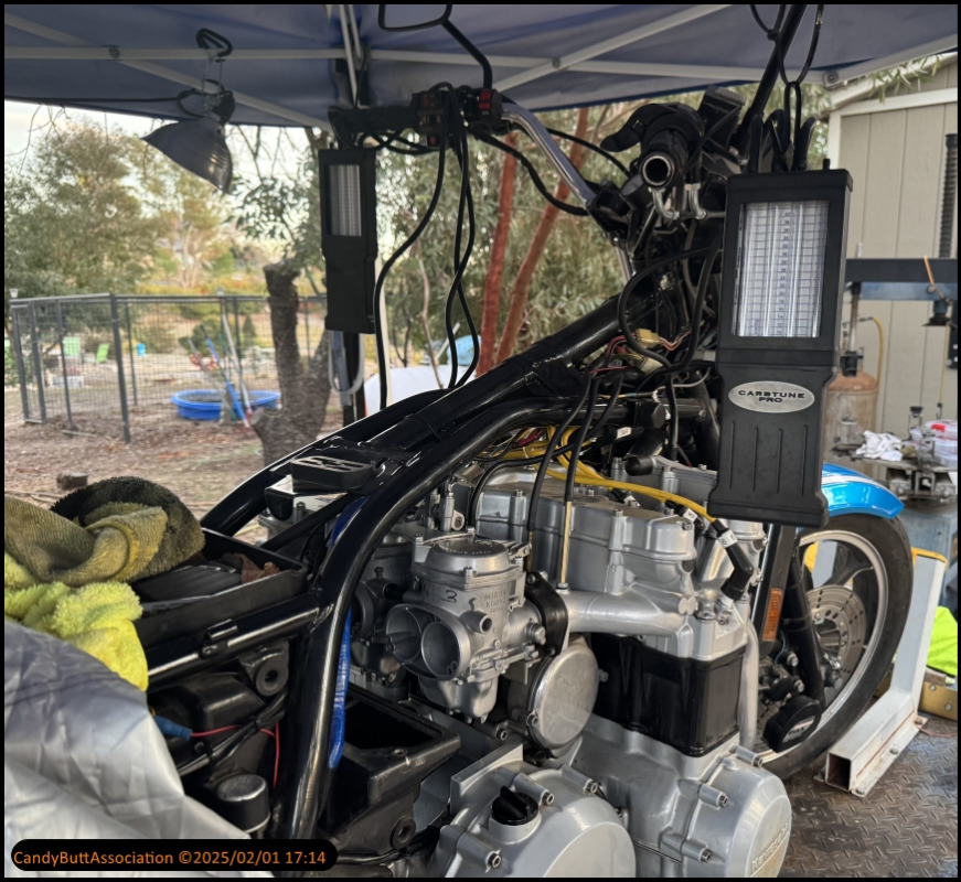

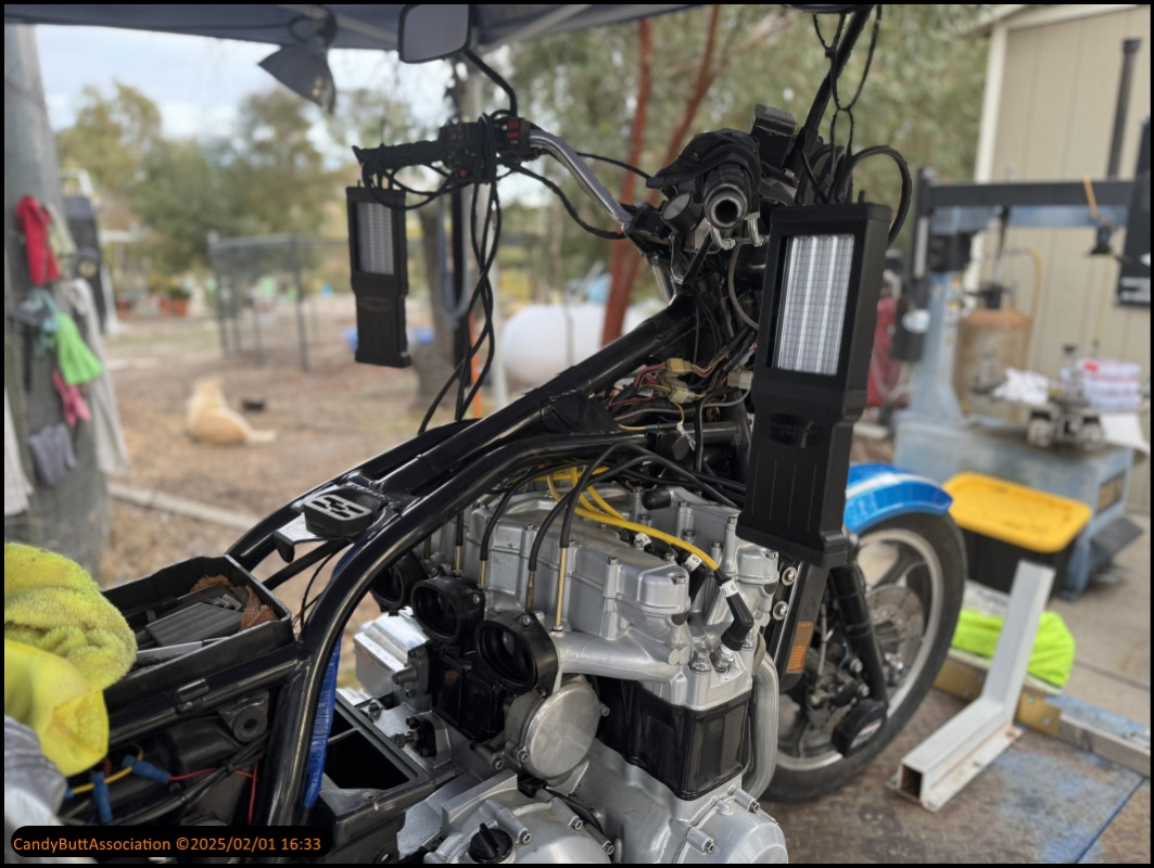

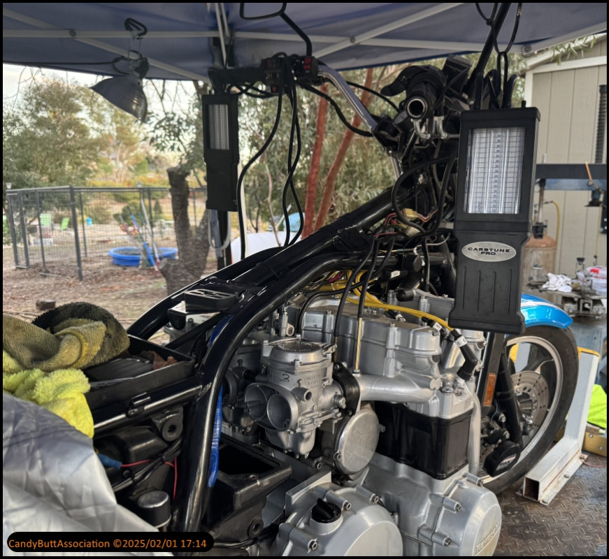

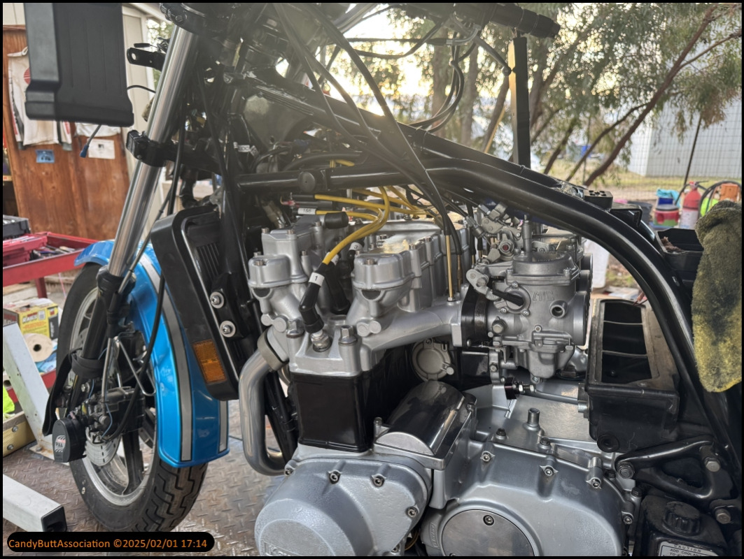

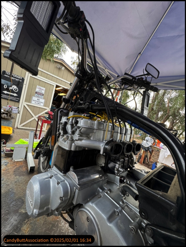

Before installing, checked that all screws were tight, but the bench synchronization was correct.
Installed the vacuum extensions before plugging the carbs into the boots. Easier that way.

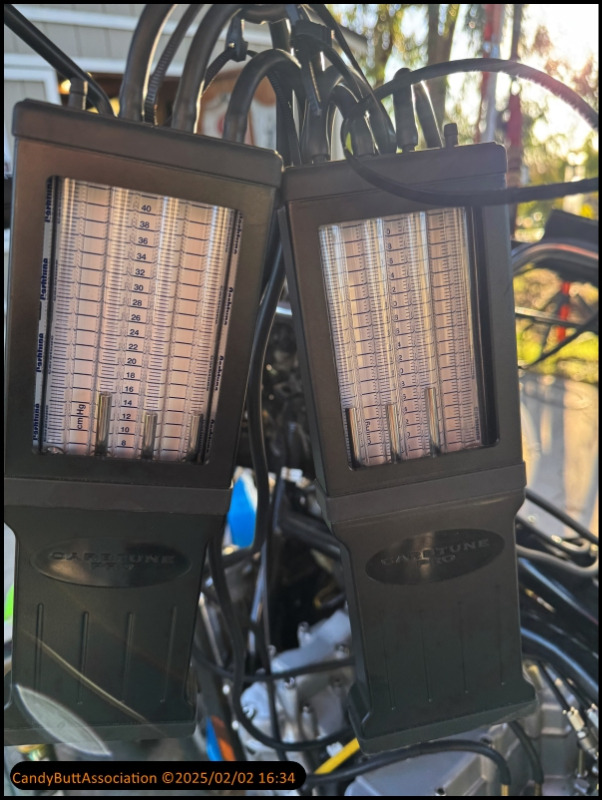

Manometers hung. I even checked that the restrictions in the tubing were the same for all six.
Pulled the spark plugs they all look good.
Installed. And clamped down.
I sure hope this works.
I would like to ride the bike while the weather is still cold..

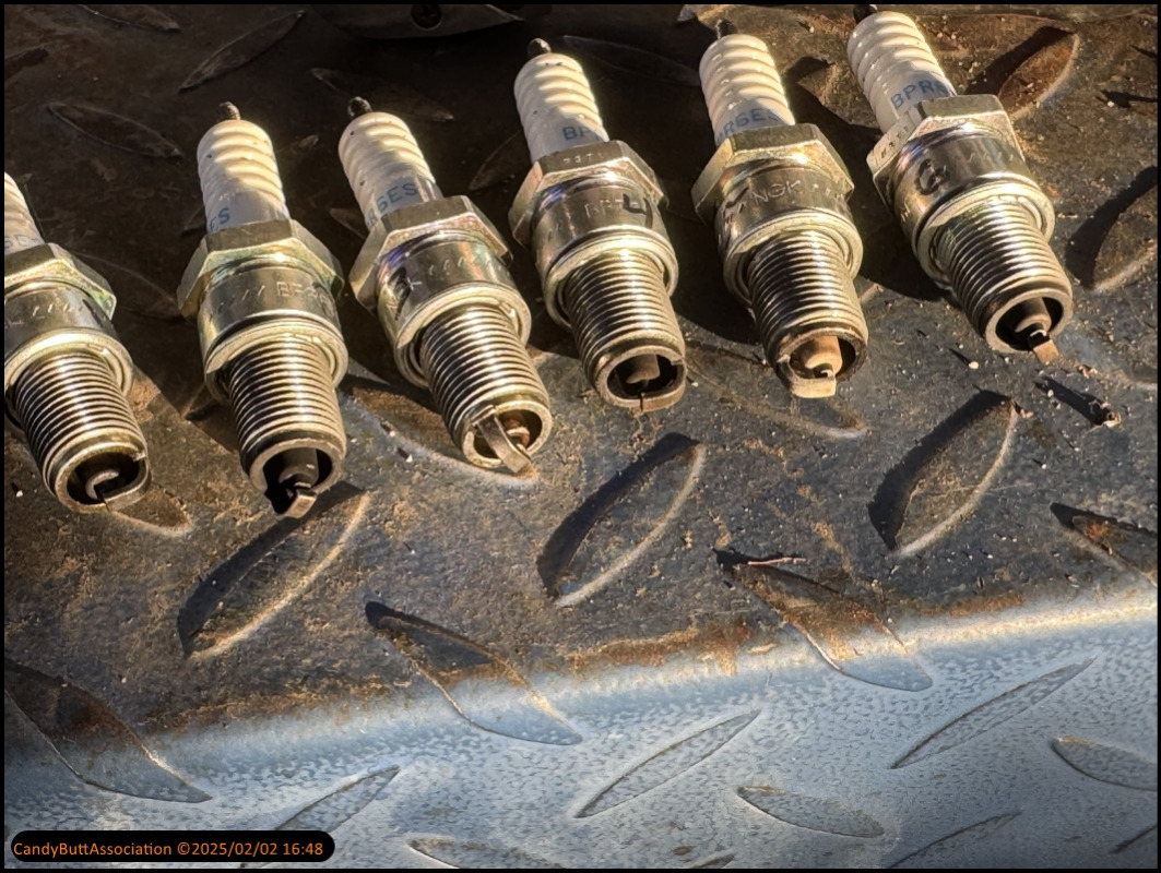

I pulled the sparkling plugs. Here is the result. One through six left to right.
I don't know why, but the picture makes the plugs. Look better than what they are.
Number one looks a bit oily, to a bit sooty, three is wet, four is sooty, five and six look great.
Is it a coincidence that five and six had the carburetor that adjust correctly?

I few things in no particular order – just what pops into my head.Firstly: It’s not necessary to have a “gauge” on each port for sync’ing. 1 Carb – 1 gauge. Reduce the clutter! Reduce the additional distractions.Although you discovered a Diaphragm that wasn’t positioned correctly; this would have no affect on the idle issues or cause excess fuel. Regardless of Main-Needle height that the Diaphragm may have affected; no fuel can be delivered by the Emulsion-tube/Main needle until the throttle is opened considerably…enough to have the air velocity “Siphon” the fuel from the top of the E.-tube. Fuel acquisition is completely different for the Idle and High speed. Engine vacuum (“ Hg.) on the engine side of the throttle-plates is significant and quite different from the “Siphoning” affect (“ W.C.) on the air-filter side. It's the air velocity over the top of the emulsion-tube that draws "high-Speed" fuel. Focus on the inches Hg for your issues.Not sure what is meant by excess fuel “dribbling”. All jets and porting are above the fuel-bowl level. It’s the “inches HG” that draws fuel up an into the idle circuit. Not gravity. No Vacuum – No fuel.The answer to a previous question regarding a “seal” for the emulsion-tube is: No.Are you using OEM or similar springs on your pilot-needles? If the spring is too long/wrong gauge/too many coils it will feel like the idle needle is closing full stop when in fact the spring is stopping it from doing so.
