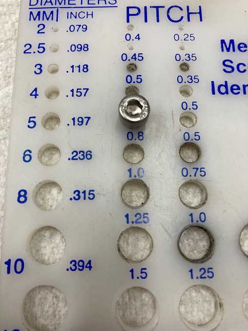

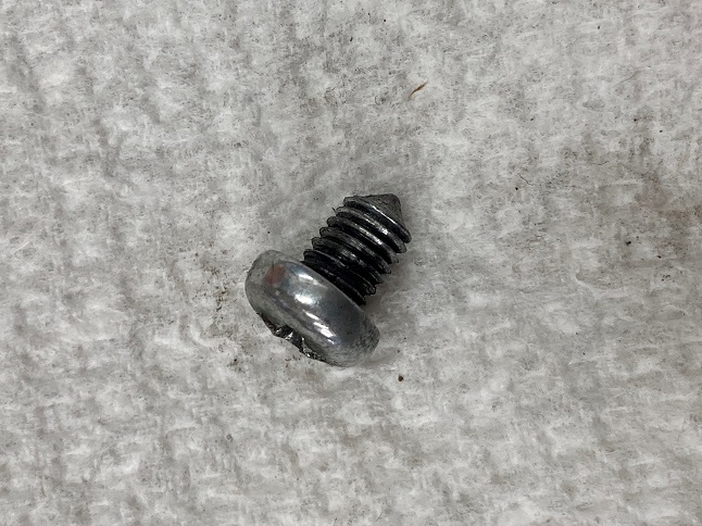

The "fix" is easy ! It starts with 3 socket-heads that replace the Philips screw that's use to secure the Choke Plunger lifters.

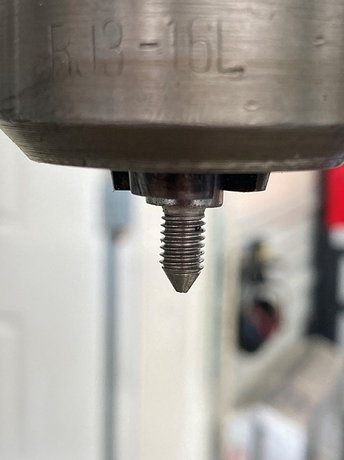

It requires a point similar to the OEM screw. Easily done in a drill-press with a file.

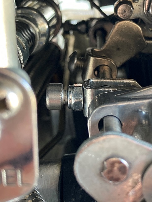

With a jamb-nut, the new screw replaces the OEM Philips
Turn in the new bolt until is stops in the "V" of the choke-rod, then back it off about 2 turns. This was an arbitrary setting that I found I didn't have to screw around with ! There will be a need to make minor adjustments to these screws in order to Sync the lifters. Something that could not be done previously. Secure the bolt with the nut. NOTE: This new bolt does NOT secure nor is intended to secure the lifter to the choke-rod. The lifter now "Floats" on the choke rod and does so without any issues ! Now, The plungers lift later with choke application and close sooner as the choke is reduced. The delayed lifting of the choke plungers does not have an adverse effect on the fuel or air availability within the choke system. It merely changes the ratio of choke fuel/air relative to the position of the fast-idle roller and cam, along the primary (long) slope of the cam.
Each morning for five days I tested this modification with a cold start. The engines starts immediately as expected but the dramatic affect is a choke application (actually the reduction of) that is linear and predictable with an appreciable stability in the RPM's.
No more "jockeying" !
