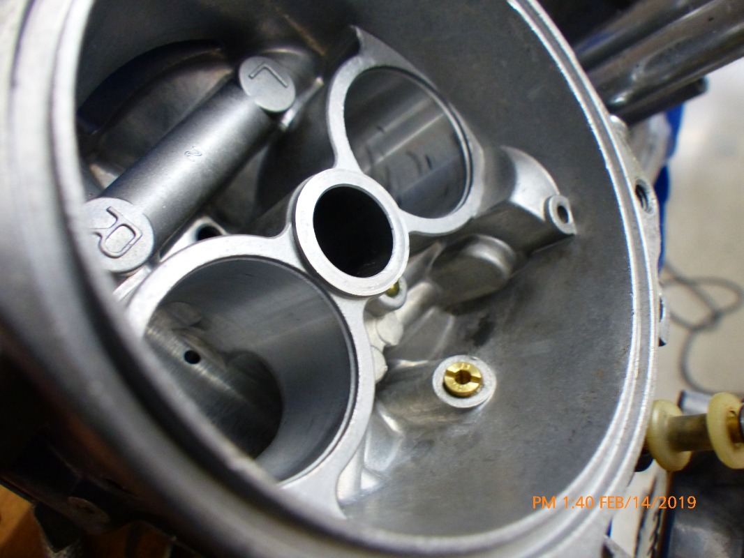

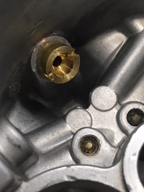

Scotch’s carb mod fixed that problem for many of us.

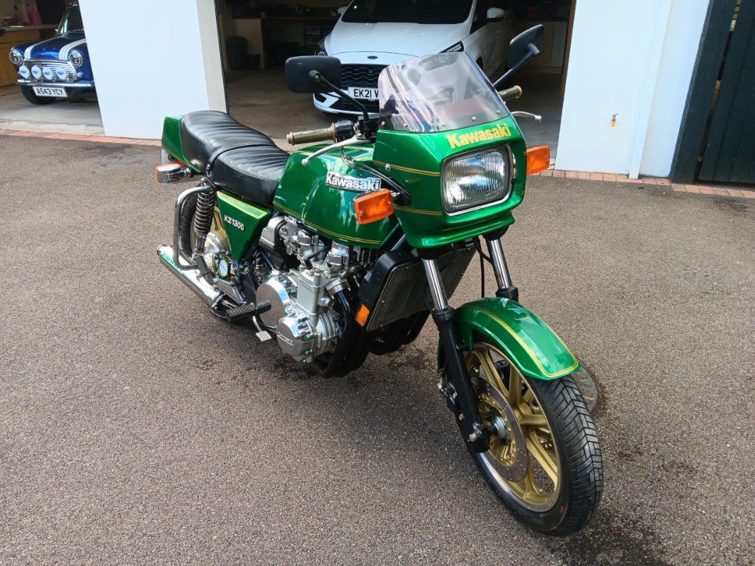

Your bike looks great, Bruce. Could you please post some more photos, and tell a little about what work you did to to it?
Does that Mini, and the Ford belong to you too?
