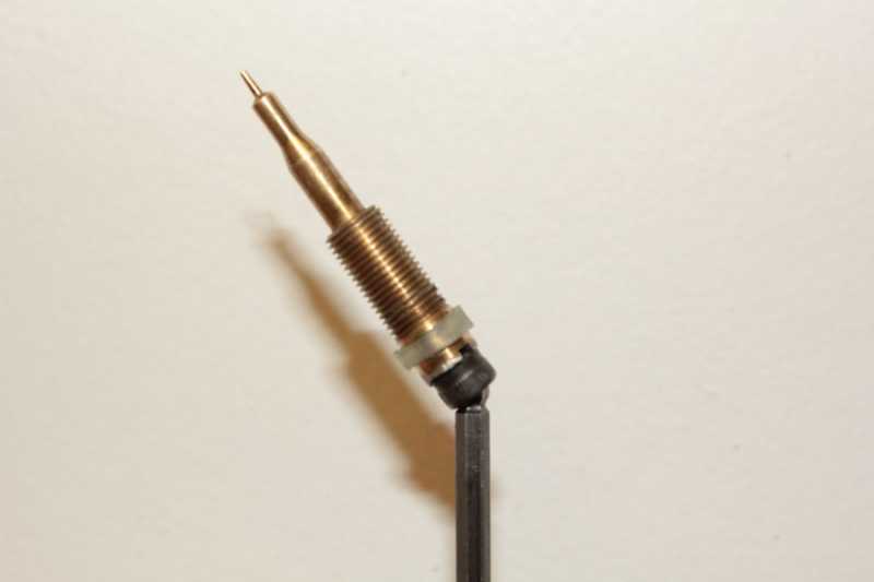

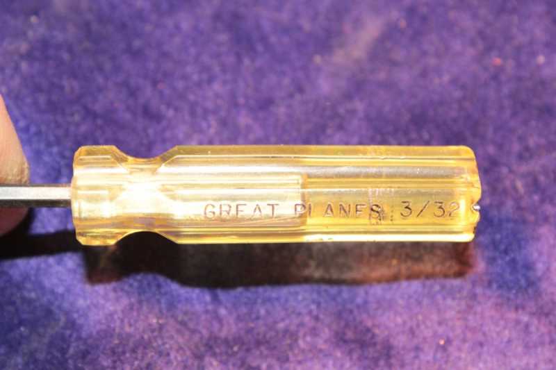

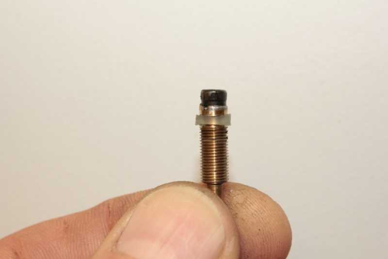

The slotted heads on the idle-air screws are ridiculous. Especially when making adjustments on the center carb. Consider this: Cut the heads from an appropriate size socket head machine-screw and solder one to each idle-air screw. (Note: If you can't solder to save your ass- get some who can to do the soldering for you). Now, with a "ball-end" allen-head driver ( magnetize the end) the adjustment, removal and insertion of the idle-air screws is EASY ! The magnetised allen driver also makes it easy to remove and re-insert the idle-air needle springs! To help you with the accuracy of the "turns-in/turns-out count", mark the top of the Allen-driver handle with an arrow. Now you can register the position with no more......"crap...how many was that?"

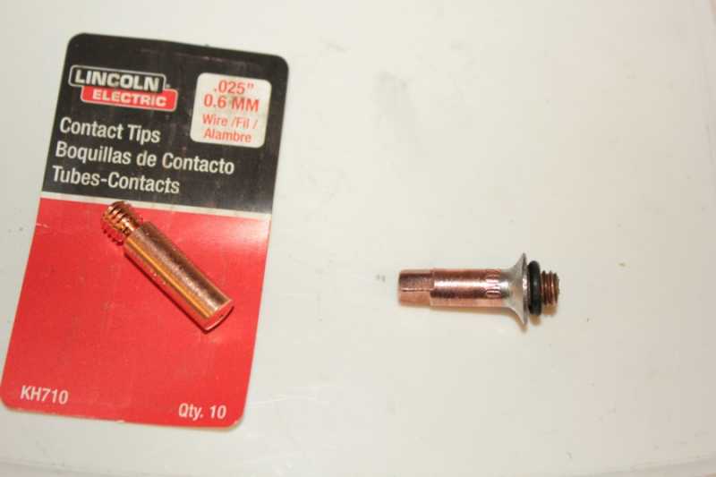

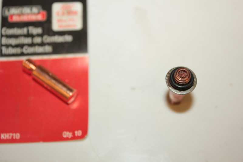

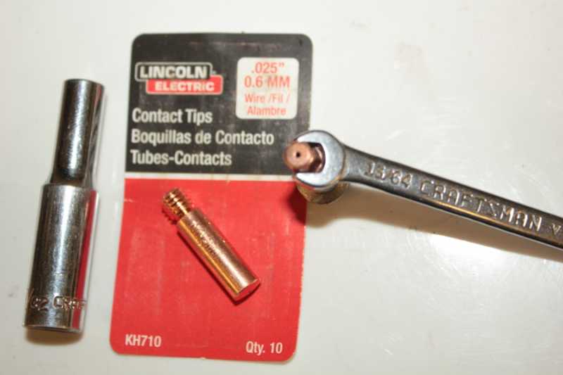

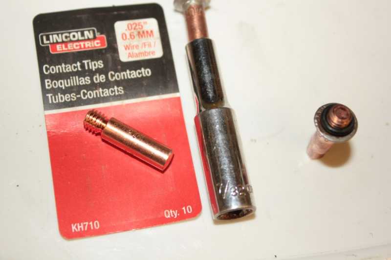

1) For manifold vacuum adapters I use 3 mig-welding tips. ( Wire size is irrelevant and the thread pitch works just fine). Solder a washer at the top of the threads and roll-on an O-ring. If you choose to you can pre-drill the threaded end to a larger diameter and press-in some cotton to dampen the pulses to the gauges. The mig-tips I use have a hex-head so they can be installed,"snugged" tight and removed with an appropriate size socket.

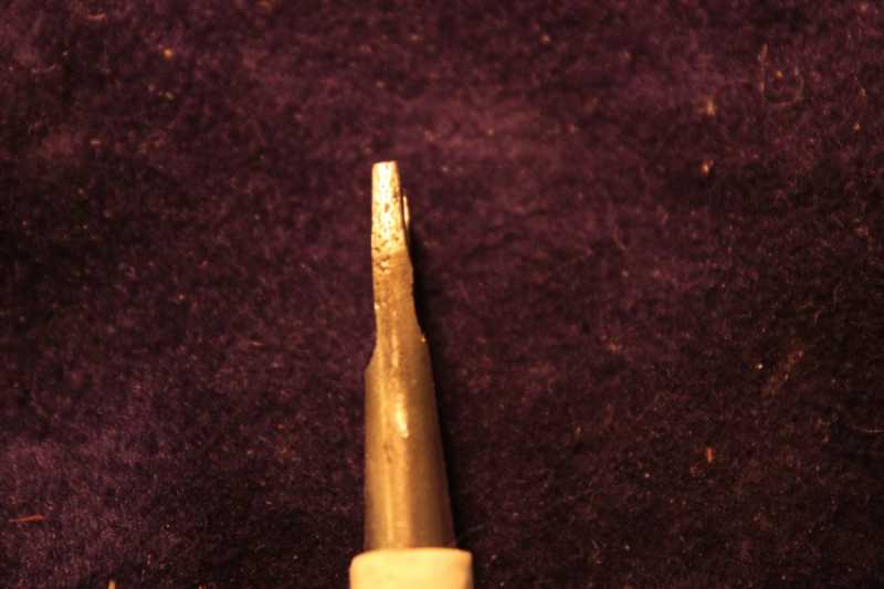

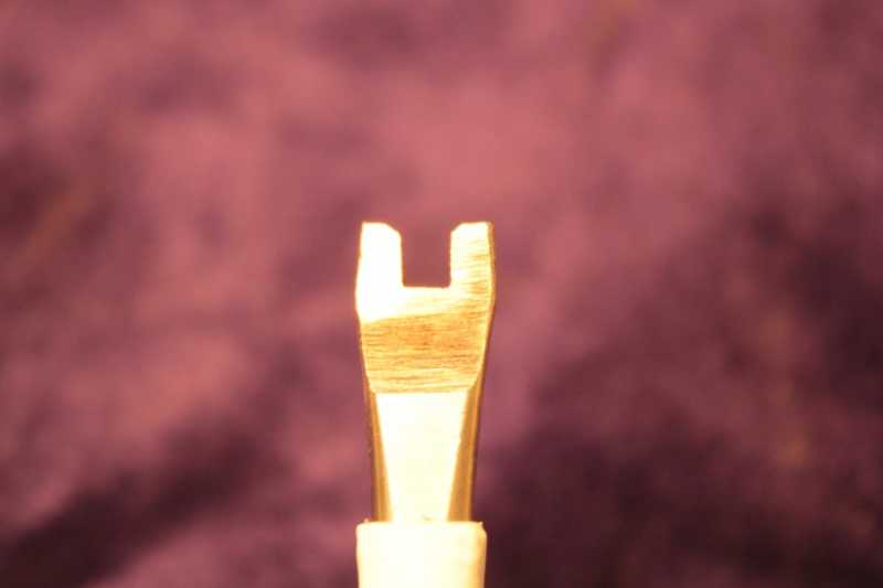

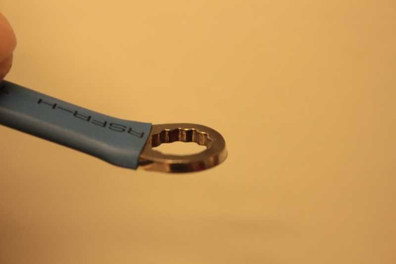

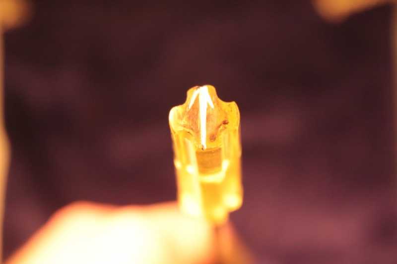

2) Accomplishing the actual sync-adjusting is much easier if you have 2 tools. one to tighten/loosen the locking nut and one to turn the 1/8" hex-head adjuster. For the nut: Grind-down an 8 mm wrench so the thickness matches the lock-nut. For the actual adjuster: Find an old flat-blade screw driver and with a "Dremel", cut a 1/8" notch into the tip. The accuracy of your adjustments will be surprisingly easier to achieve.

Hmm interesting, I can use one of those mig tips to supply vacuum to the GPZ900 petcock, was thinking of using a grease nipple and soldering on a bit of tube, but that sounds easier, thanks for the tip, cheers Pete.
