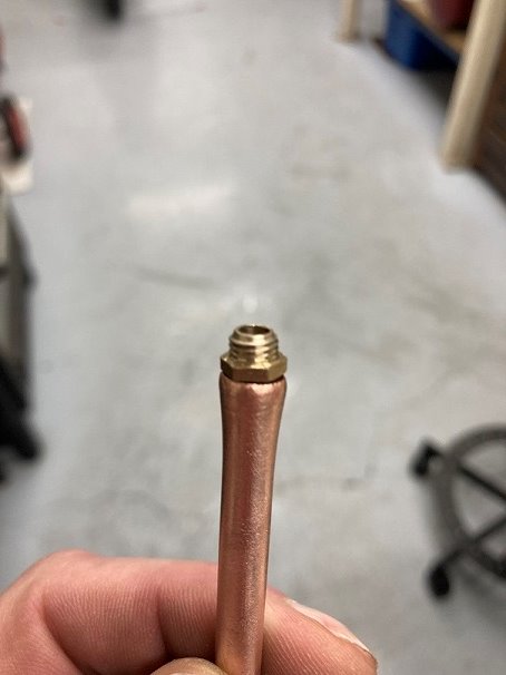

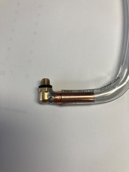

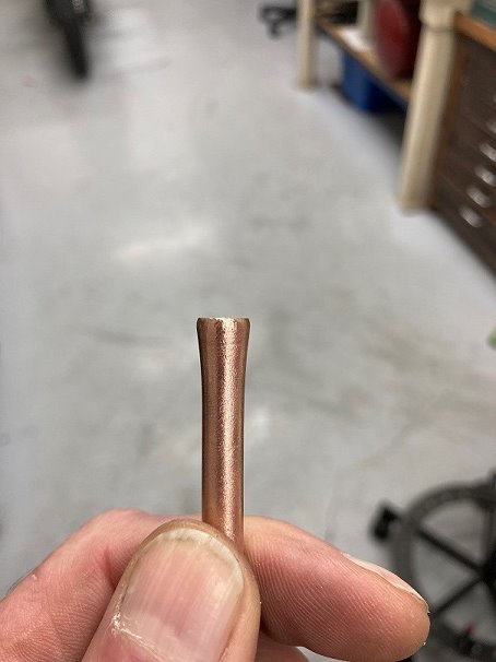

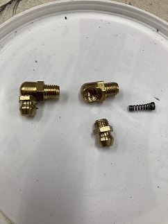

While doing a web-search for fasteners, I came a cross this:
A brass grease fitting with the same thread (M5X.5P) as the fuel bowl drain...
Drilled out the end and removed the check-ball and spring.
The rest is strait forward.
add an O-ring and......
A. Hold your horses Kawboy ! One hoof at a time !

I do like the 90 deg elbow design . And a different way to milk a Kaw.

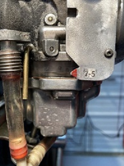

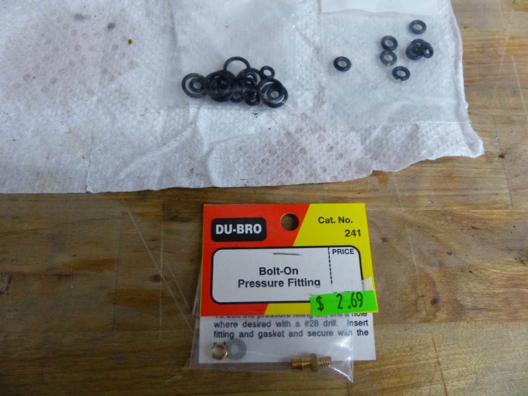

These are a #6-32 thread.
I did this mod a couple of years back

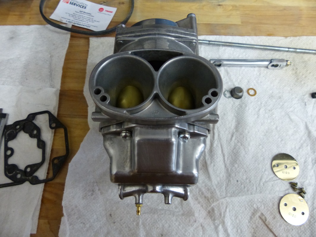

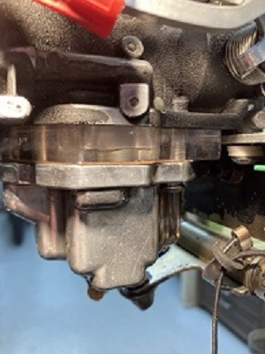

I never did and still don't care for the '79 bowls. If you have experience with both styles you'll probably understand. None-the-less..... a bit of imagination, a few minutes at the bench and there's always a (another) solution to a goal.
The idea behind the Clear Spacer is to eliminate the need for the level-tubes.
