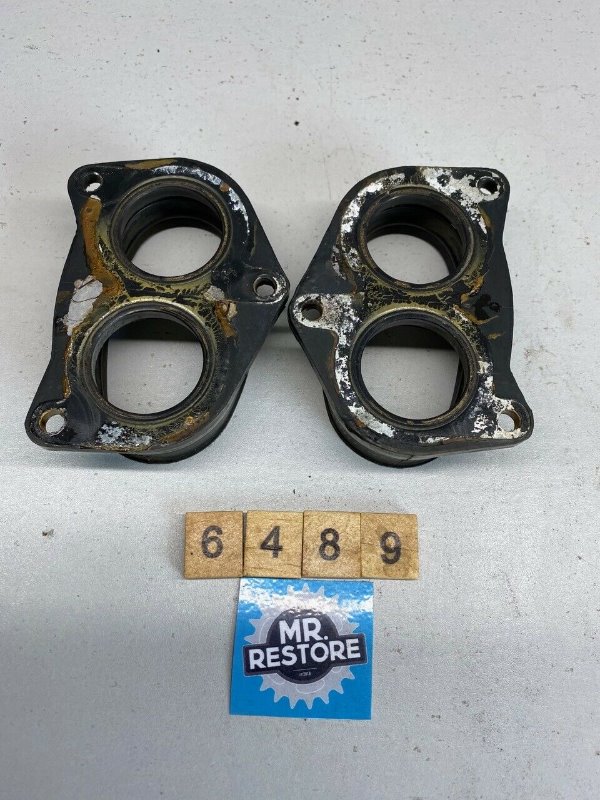

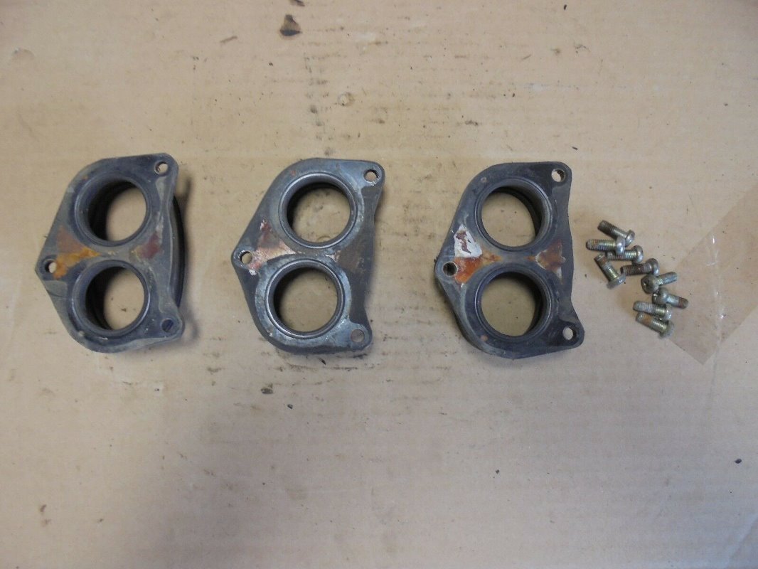

Now is a timely moment to mention something else. I discovered this past summer that I had leaks on all 3 carb holders. The sealing lip immediately around the ports that mate with the cyl. head had dried and shrunk. The rubber on the mating surface has many voids. I removed the 3 holders, sanded the surface clean, smooth and down to bare metal, then installed a gasket on each.
Something to consider. Making 3 gaskets is easily done and will solve what must be a common problem, based on the many eBay photos of these carb holders being sold .
They all show the same problem.
Last edit: 5 years 9 months ago by scotch.
