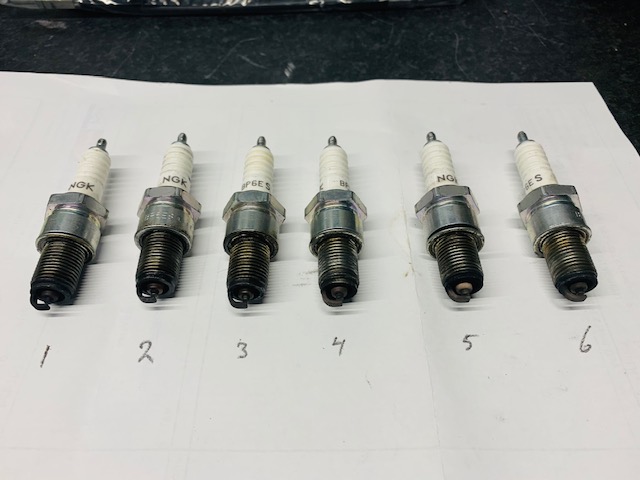

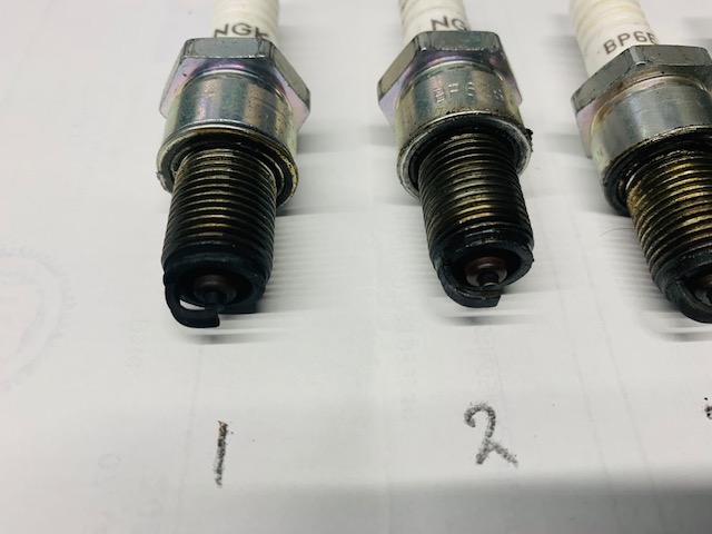

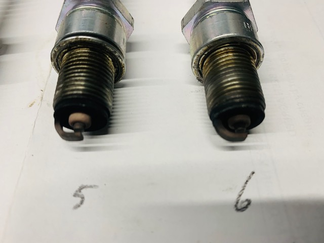

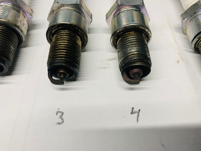

  • McBoney
  • McBoney's Avatar
  • Posts: 561
  • Thanks: 87
Re: ColurTune Test on a 1979 A1
5 years 9 months ago
#28471
paulb wrote: the one thing i found using it was that there is quite a wide band for the blue colour recommended so i just got mine to a slightly rich colour and backed it off until it was blue, i am hoping it will help with starting but time will tell
I did exactly the same thing and it starts nicely, with choke from cold but that can be switched off before I get to the end of the street. However, tick over when riding is a little lumpy and it is slightly slow on the uptake,...
As I had to take the thing apart to check the fuel level sender I pulled the plugs to have a look-see.
I have done some 250 miles in total and before taking these out I had just done a 20 mile journey at averagely 40mph with the last mile at around 20 mph, then switched off.
Any thoughts as to what the plugs look like and where I need to adjust the mixture?
