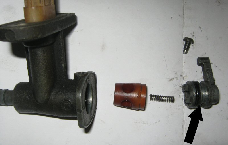

Must be an aussie thing mine is an 83 model and has the same valve as the picture.
- Posts: 594
Re: 1300 stock fuel-valve (petcock)
10 years 11 months ago
That edge arrowed is worn from the screw and I guess there should be a tab to stop the tap turning 360 degrees ??, the tap does turn right around, have 2 and they both do it, guess that's from years of wear, that's why I changed to the vacuum tap, I didn't know they were different later on with the two retaining screws, might have a look around to see if I can get one of the "better" ones, cheers Pete.

I just thought I’d bring Scotch’s post on modifying the fuel tap to the fore again, since there have been a few members encountering difficulties with the tap recently.
7 years 9 months ago
The fuel valve design incorporating a single screw to hold the guts was the original design and had issues. That screw was replaced with a design that utilized a face plate (2 screws) to retain the guts. This was to eliminate the inherent friction and misalignment created by the single retaining screw.
Lapping the cone to the body can repair a leaking valve if the damage is not to deep. A slightly lighter spring and filing down the "Tabs" that fit into the cone, can return the valve to an operative condition. An initial smear of silicone grease on the O-ring and cone doesn't hurt.
Or you can always fit the VACUUM type petrol tap off a KAWASAKI GPZ900R,A4 /1988.
You will need to run a short vacuum pipe from your inlet track, which is easily done.
As this is a vacuum type tap, it stops petrol passing thru as soon as the engine stops running which is the reason they are fitted to modern bikes.
