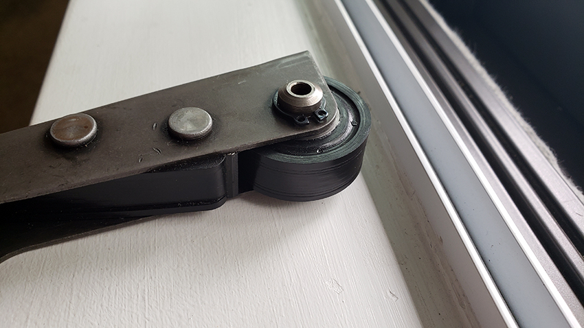

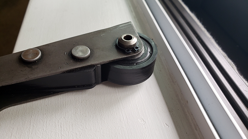

Idemon, I'd suggest digging in again with your camera piece. The roller of the tensioner is right behind the cam chain tensioner and is facing the inside of the engine, so you'd need to do it from the top through the cylinder head (it's directly below the nylon sprocket, at the other end of the metal piece that sits below it).
For reference, this is what you are looking for. The cam chain should be sitting on the roller - the tension from cam chain tensioner is applied to the chain with this roller.
If it's messed up (in this case would be more like missing), the cylinder head must come off. It's much easier than swapping the engines.
