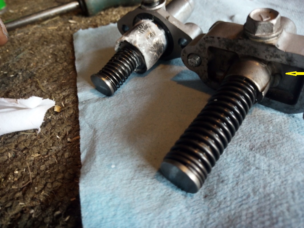

Second look and an observation: I see black pieces of what looks like a chain or a tensioner guide.
- ldemon

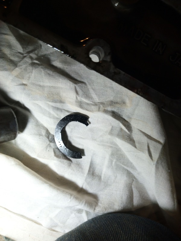

I see this half moon is metal, right? It looked like dark rubber on my phone. In this case, that bearing at the end of the shaft with spacer is a good guess.
