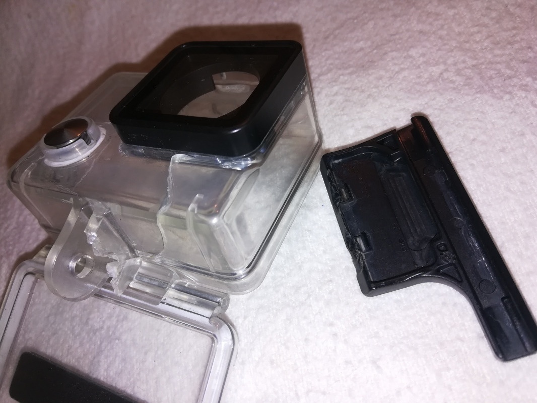

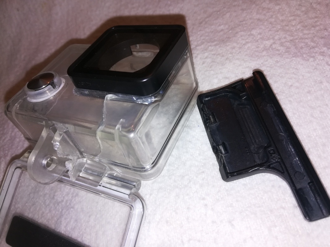

This is the damage to the camera case after 25 min of riding, probably from the air resonance in the airbox. I thought that the light bulb will burst first but it was the opposite :woohoo:

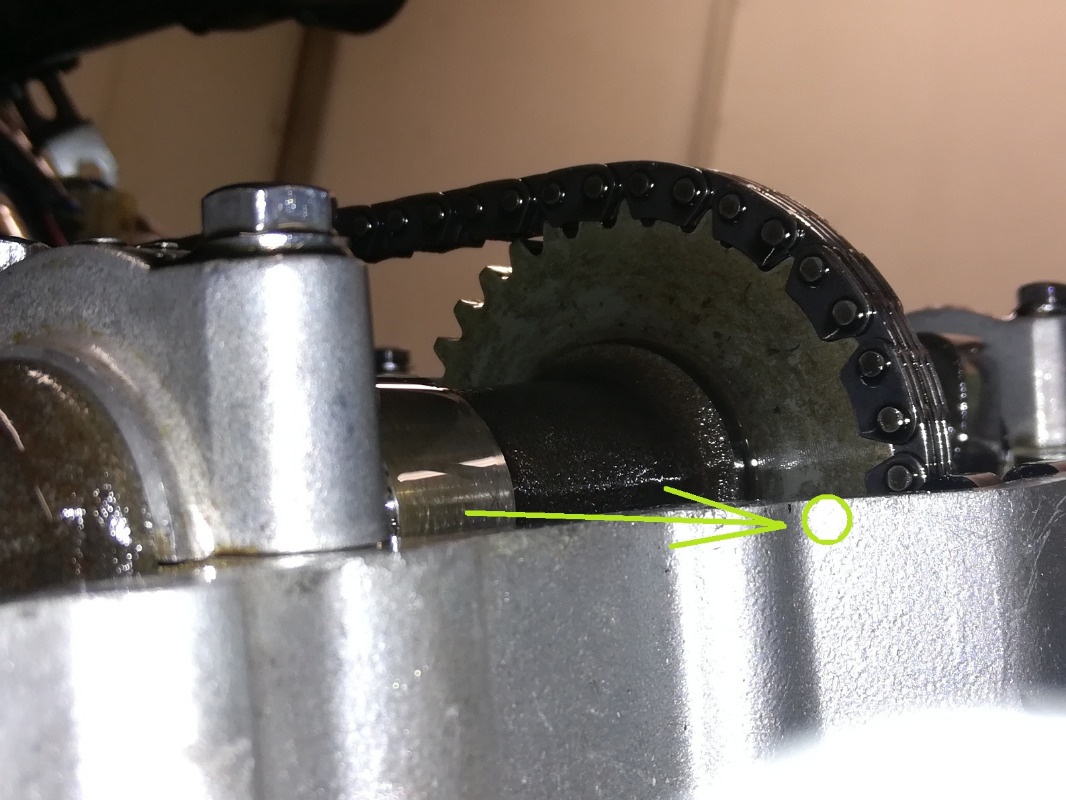

Constant velocity carbs were designed to overcome over rich conditions under low rpm and wide open throttle conditions. That's why you should see a steady opening of the throttle chokes when you crack the throttle at low rpm and ramp up in speed. The throttle chokes should follow the rpms up to about 4000 rpms then hold wide open. That meters the fuel from the mains keeping the ratio closer to 1 lambda.
.68 lambda is really rich. The visible spit back in the carbs suggests late closing of the intake cam. I would rather see the cams advanced than retarded.

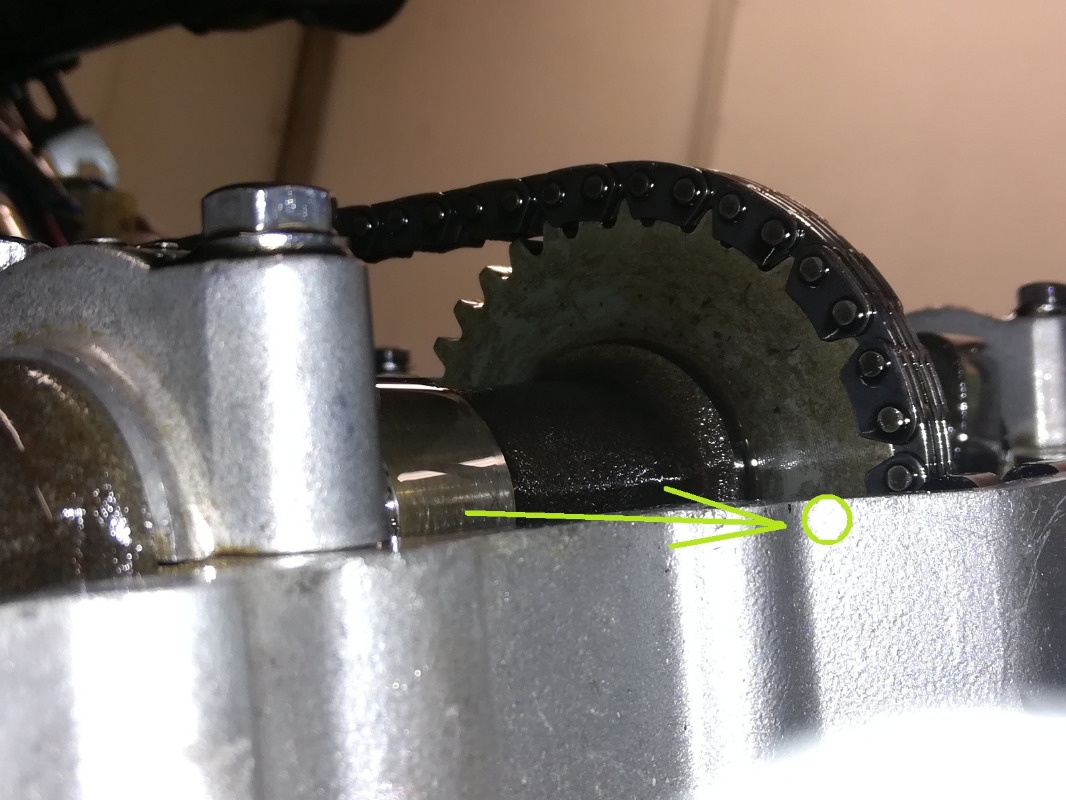

#24171

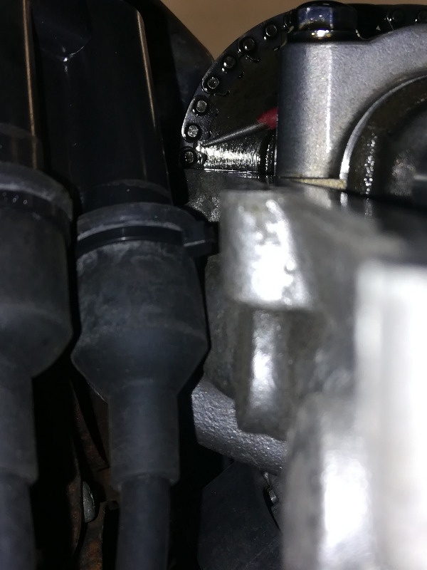

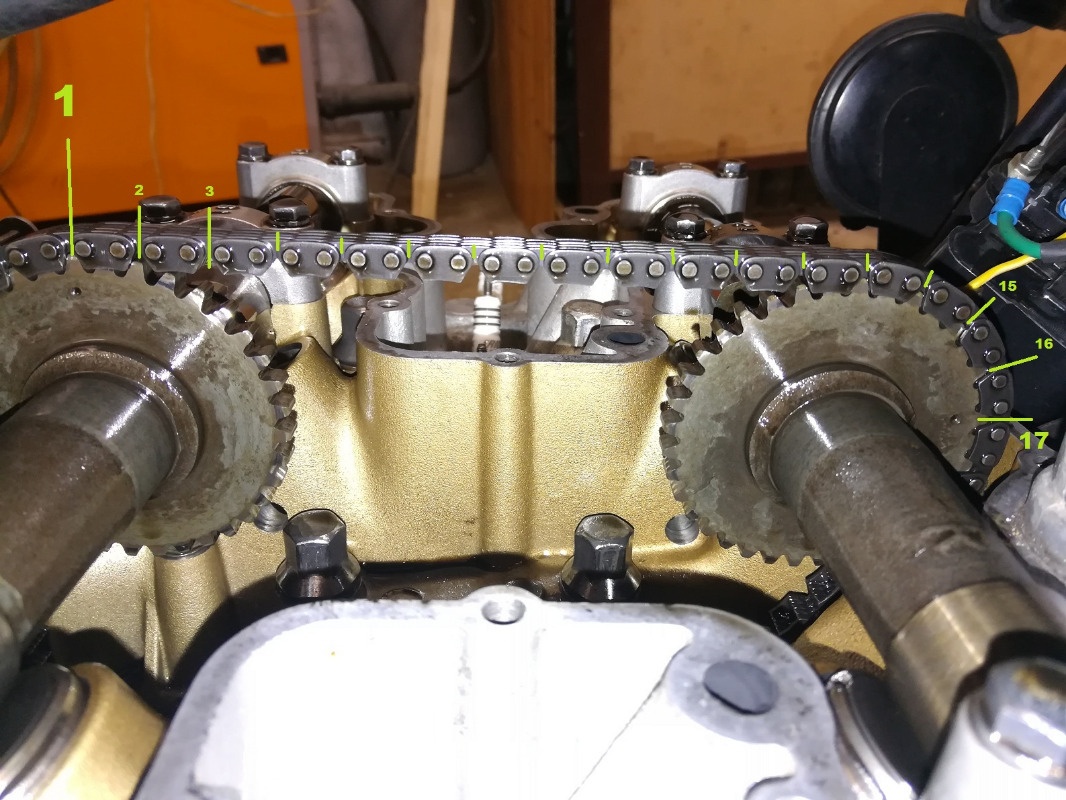

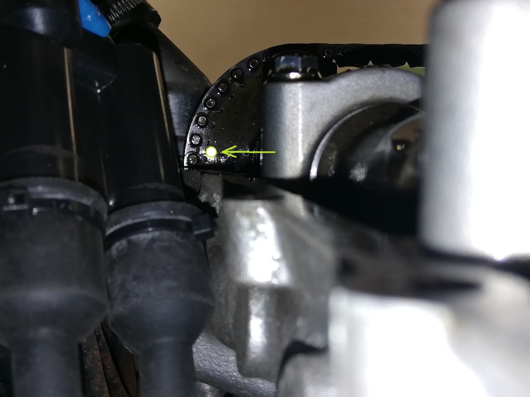

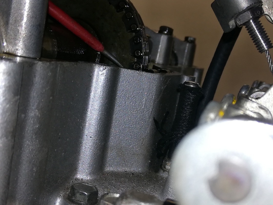

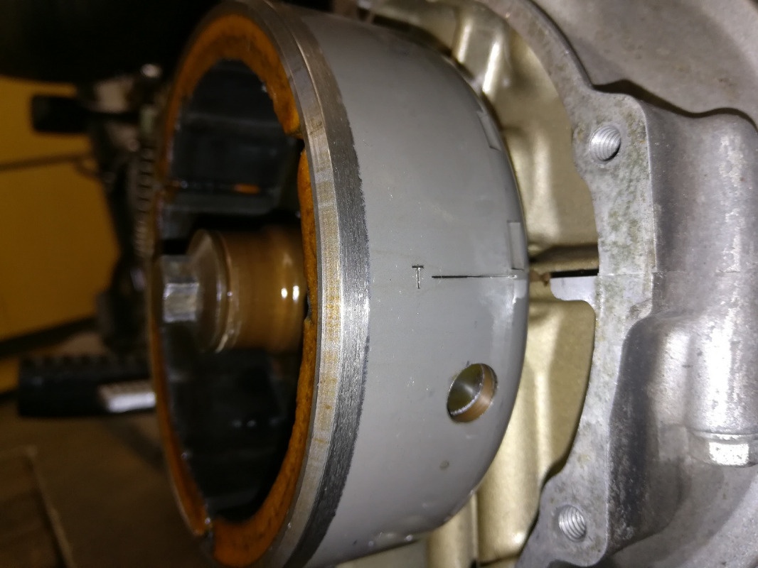

Hi, i took the valve cover off and rechecked the position of the cams. So as Kawboy suggested: " I would rather see the cams advanced than retarded" that's not the case in may engine, which can lead to "You've got a serious problem with Fuel Stand-Off" mentioned by Scotch, because the air pulse flow is disturbed. When i installed the cams i thought it will be better when the intake cam marking dot is closer to the head surface when setting up the cams and those 17 links between the dots, because i was unable to set both points on cams spot on on the surfaces, so i had to choose between theme. Hmm something tells me that both cams should be advanced one tooth. What ya think guys ?
Exhaust cam from the left. This is where the dot is on the other side, to me looks to retarded.
The intake cam also from the left. And it seems to be also retarded ?
Once again with screwdriver pointing at where the dots are on the other side.
And finaly TDC and 17 links between the dots
