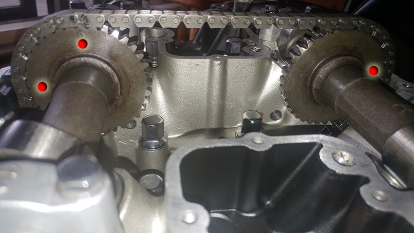

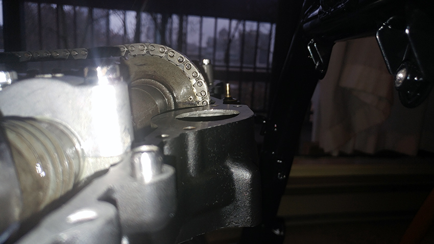

Hi Stan, that's what i was thinking before, when assembling the engine for the first time. The markings on the sprocket from both camshafts didn't line up like on the picture in the book. So i was thinking, well i take the intake cam and position the marking closer to the head surface, and so it took place.
Re: Lean Idle

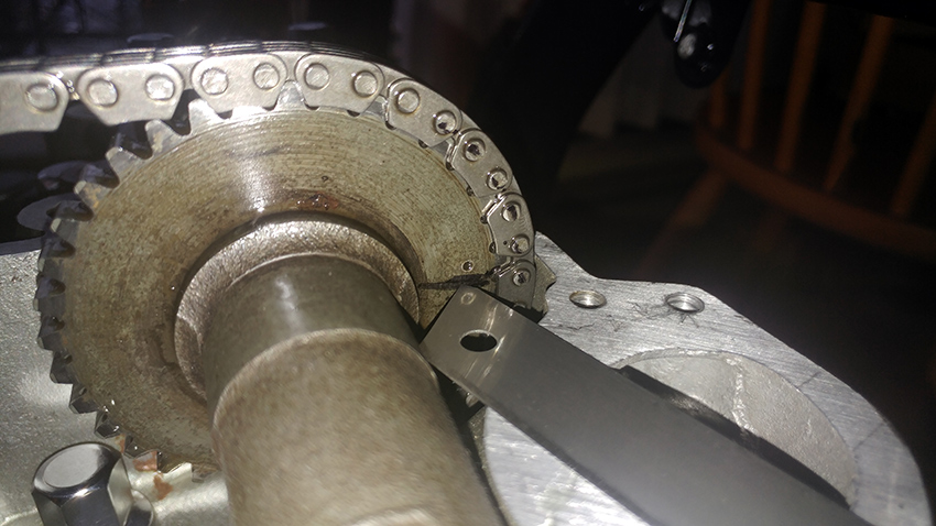

I will re-post photos of mine. As you can see, they were also not perfectly aligned, and I was panicking just a bit. At the time I was assured by many people that they have the same or similar arrangement and the bikes runs great. The one important thing is to keep the link count - and you have it right.
The link count is from the exhaust side. In my case the dot didn't want to align perfectly, so I chose it to be above the edge rather than below - to balance position of the dots on the intake side. Choosing below the edge would bring the markings on the intake too far from the edge. I think in your case it is quite further from the edge than mine. Maybe it will look fine when moving it, and that would also bring the markings on the intake side higher, closer to the edge. As far as know, these markings never match perfectly as written in the book. And yes, the chain length question.
The blade is sitting flat on the case.

And as Stan has pointed out.......my cam alignment marks are not a perfect "Manual" match, either. Never have been.
Chain-stretch causing the issue of fuel stand-off - - I highly doubt it.

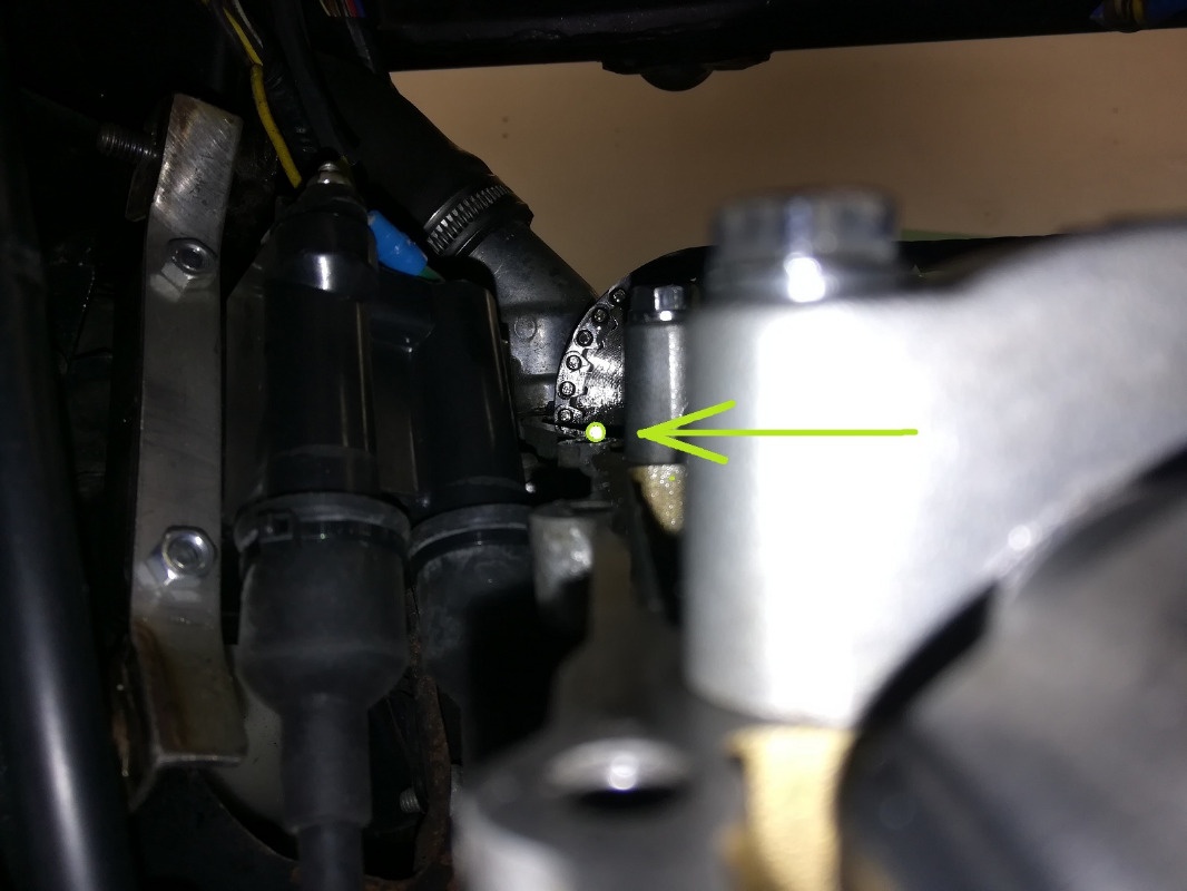

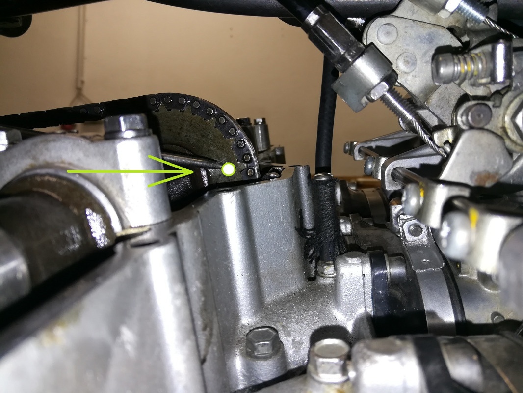

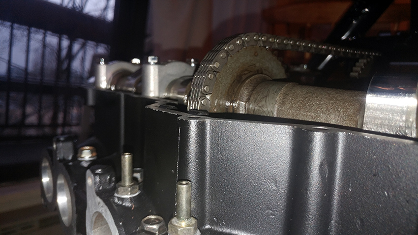

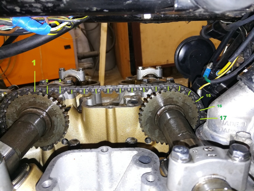

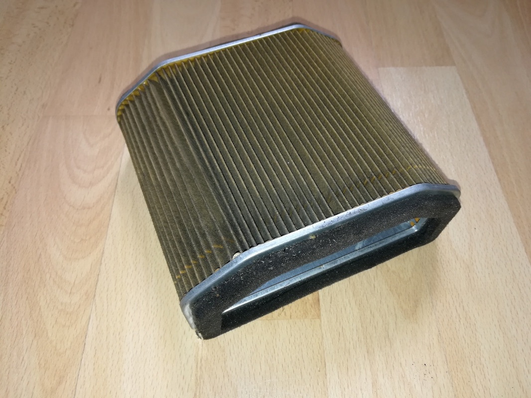

So i just tested the bike with cams advanced one tooth. Here are the pictures.
Intake cam with new position
Exhaust cam also with new position
And finally 17 links

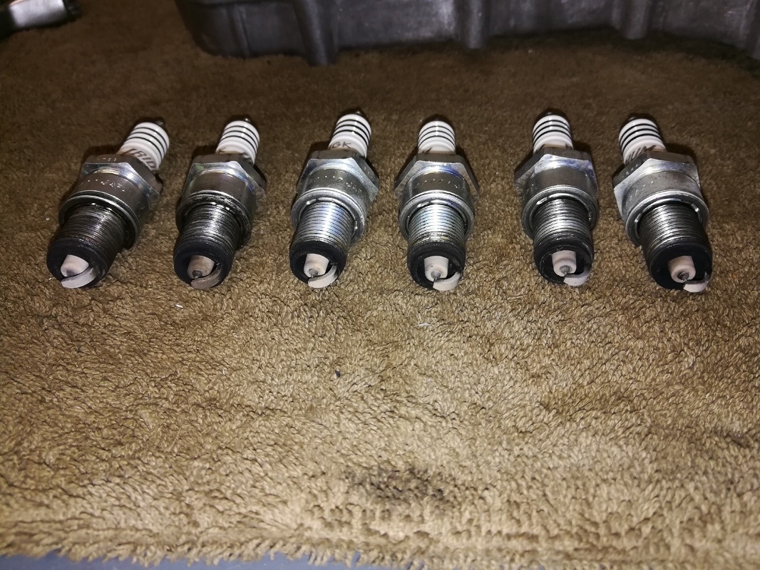

These are the spark plugs before the change
And the air filter soak with fuel from the fuel standoff
The bike started normally when cold but the fast idle seems to be waaay to high now, quarter throttle ride on 1-st and 2-nt gear, not much difference but 4-th and 5-th gear from 3000 rpm towards the red line (i stop on 180 kmh Gps) on sudden WOT delivers totally different engine and lambda value behavior.
So this dramatic fuel standoff was caused by wrong setup of the camshafts in relation to the crankshaft, because the dots on the sprockets in my opinion are not well placed or something like that. Interesting tho on the picture of Stan's exhaust camshaft the dot seems to be where my one was before the correction. I thank every one, i could not done this without you help. I'm going to take the next video when i sort out some other camera and than post here to update.
