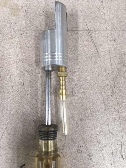

Cleaning Tool - Out of stock currently but have just placed an order which should be ready in 2-3 weeks. Despite a 40% TARIFF on aluminum thanks to "You Know Who" the price remains the same !

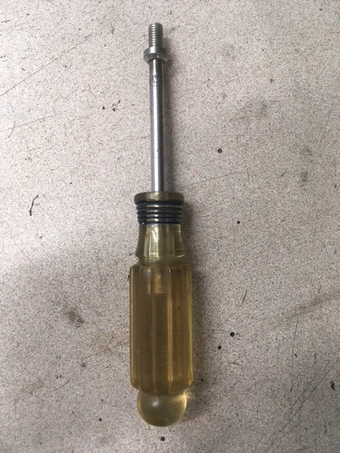

This and future production runs will include a 1/4X20 threaded hole to allow the user to make a handle to aid in insertion and removal. The "handle" can be as simple as:
OR
OR, as I preferred, a modified screw-driver:

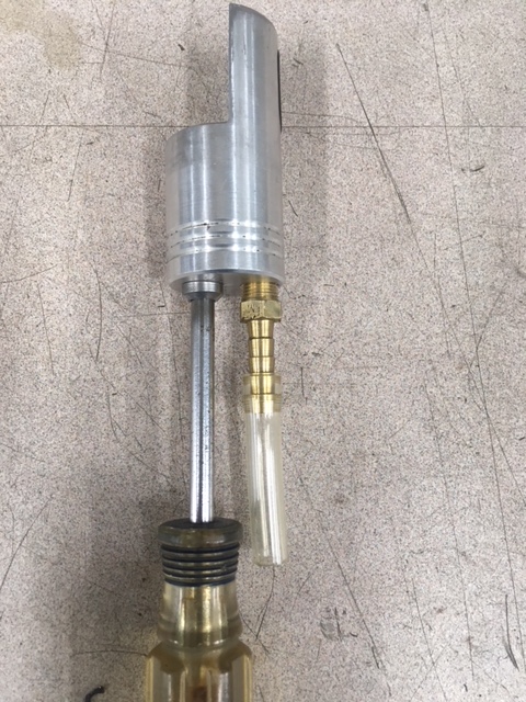

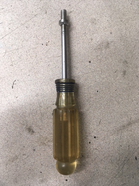

OR

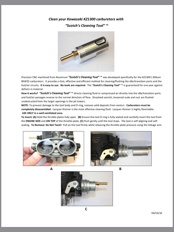

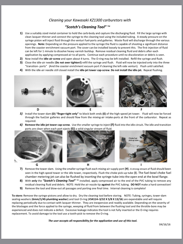

Hi scotch. 2 queries
1. You say to use laquer thinners. I cannot find this in the uk. Can you elaborate on whats in it.? Is it paint thinners etc. Many kinds of thinners do not have the strong chemicals anymore due to h and s and enviroment.
2. Can you point me to your article which shows the tool in use.? Have looled for hrs but cannot find it in the tech and past posts.

.....and I can't find the Instructions for the Cleaning tool ?? They were here, I thought in Parts And Suppliers.
trying to copy and paste a "Word" file or PDF is not working either.
I'm working on it ! Have tried several times to add the PDF file with no success.

Beertad, if you search for Lacquer thinner with Google, you will find it is available from a few sources in the UK.

OUTSTANDING ! Where the hell was it ?:pinch:
