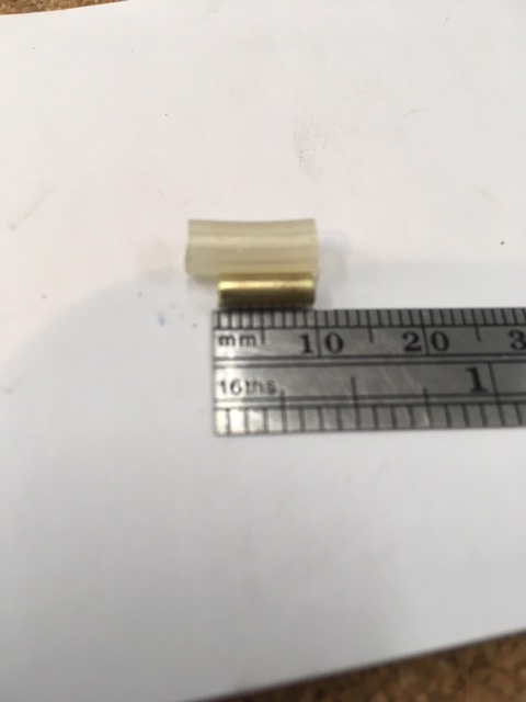

The silicone tubing is fuel-line for model airplanes and is the smaller size available and it's opaque in color and thin-walled. The Blue and Pink is heavy-wall and may not allow the brass tube to fit. Hobby Shops with have the brass also. The ends of the brass tubes were deburred completely and smoothed, for a full diameter opening and easier insertion. (Sorry for stating the obvious !):S

Where do you get the brass tubing? It's kind of nuts here when running looking for things to places sane logic dictates they should have stuff, but one after another they never have what I am looking for! haha Then back to eBay and the wait, if it's there, and often comes from China!

A Hobby Shop that has Kit model R/C planes and engines with have both.
