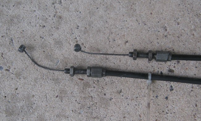

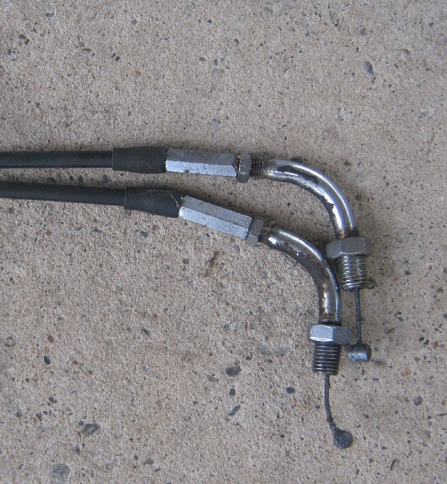

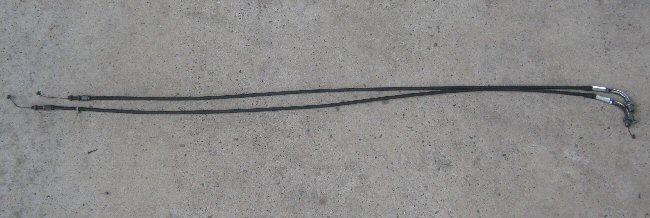

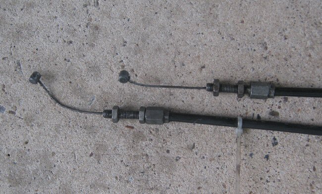

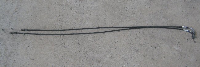

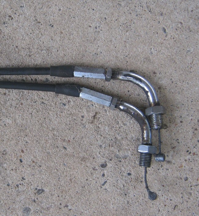

I have two cables, old ones I took off my A1 and put new ones on, one is longer than the other, which they would be, one to go to the front and the longer to go to the back of the carby connections, photos below, suppose you could use two the same length, so long as they are not too short and allow free movement when turning the bars, short one is about 40 inches and long one about 42 1/2 inches, that's measured straight up from the bend to the end of the thread the other end, cheers.

Just to add to that.... they are different part numbers so they are not the same.

Z1300 metal cable leads bent at 90degrees, the KZ's are bent approx. 80degrees.
