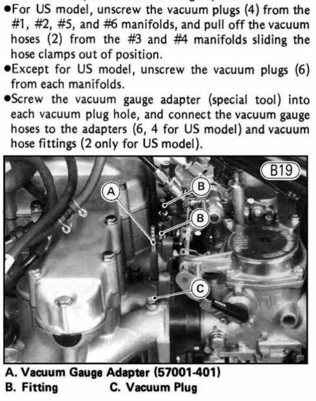

Ok, just rebuild my carbs, now I need to synchronize my carbs, which port do I use, I have a 82 model, I do see two vacuum hose in between three and four port, where do I get the third vacuum port from, Thanks.

I have a '79, one each inlet, at the top, there are bolts blocking the holes to balance your carbs, I put in some "proper" Kawasaki brass nipples on 1, 3 and 6 and use those, can swap them around if I want, when finished with the balance job I just put some silicon caps on the ends of the nipples, but that's me, don't know about an '82.

If you have the US Model it will be slightly different, I think because of the 'Clean Air System' but not sure. The bolts you are looking for are marked 'C' in the following diagram. kza13 and myself tend to use only three vacuum connections to synchronise. I have the A5 model which is essentially the same as the A4 1982.

Thanks guys, it is a usa model, perfect just what I'm looking for !!!!!!
