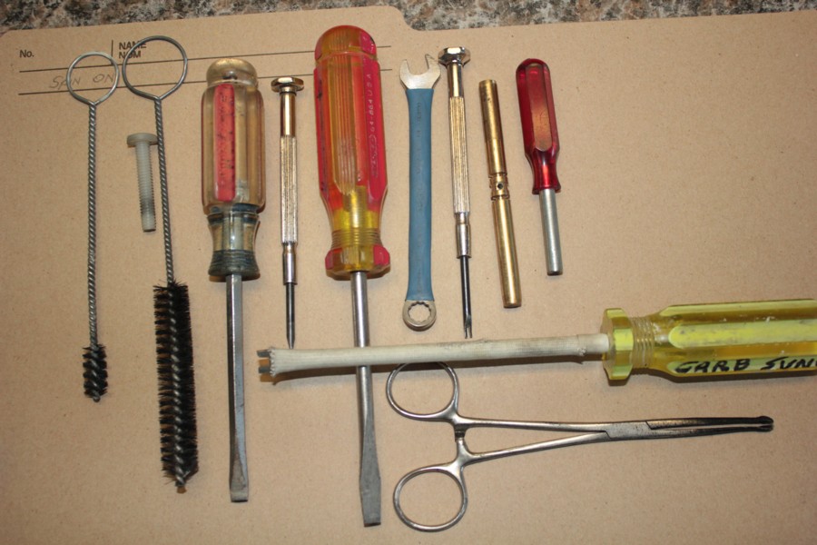

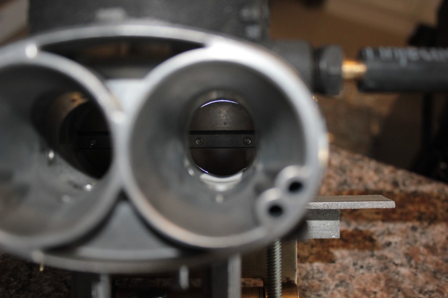

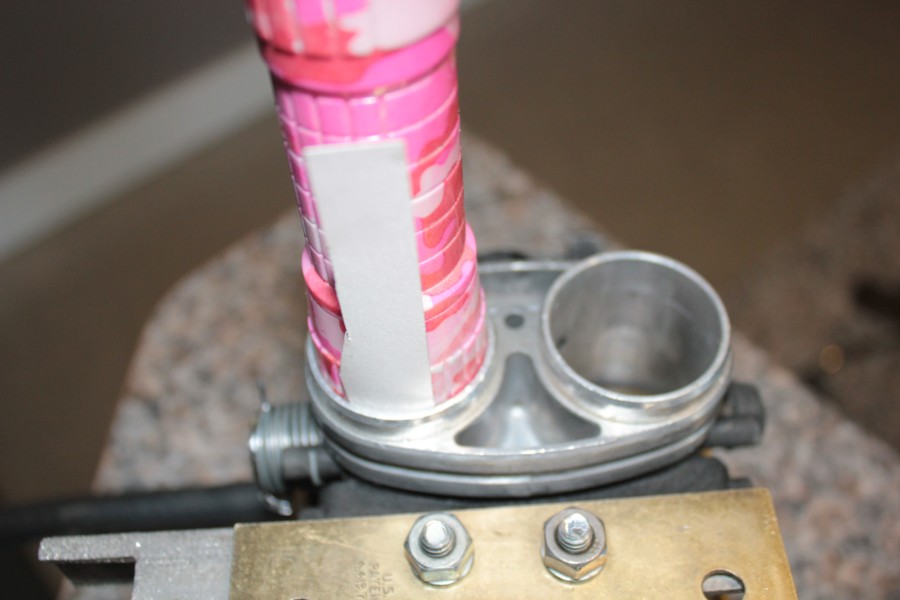

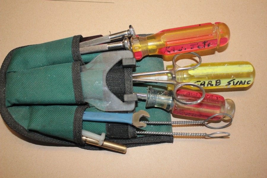

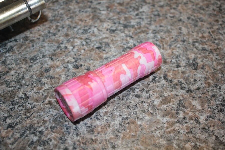

You don't need to be an "expert" to over-haul the carbs. Just a good sense of organisation, patience, a note-pad for reference notes and a phone-camera for some reference photo's. AND Some very easy to make specialized tools referred to in a number of carb-related articles in this forum. The photo's are self explanatory but will add that having an inventory of the "special" tools always at hand is the biggest asset you can have for carb.-work. I find that statically setting the carbs with a strip of paper and a flash-light works well for me.
