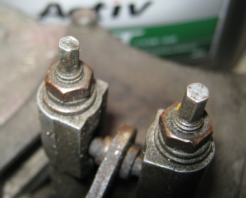

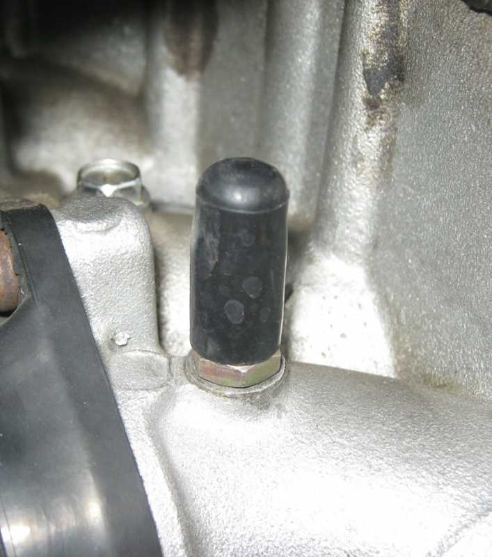

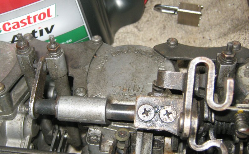

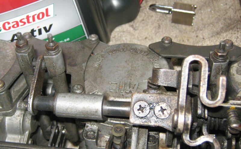

Ok I bought a Morgan Carbtune set of gauges, they are in a set of 4, that's all I used, didn't use 6 of them, heck if your linkages are reasonable on the carbies then you use 3 gauges cause adjusting one carb does 2 butterflies on 1 carb. Ok I got some brass nipples that screw into where the balancing bolts are in the inlet manifold, they are "proper" Kawasaki ones, but anything will do so long as you can get your vacuum tube over them, I put mine into number 1, 3 and 6 just to mix them up a bit, I still use the one in number 1 to supply vacuum to my petcock. You need to find or make a small tool to fit onto the hex head, little tiny thing, and a spanner for the locking nut, see photos. Run a external fuel tank, hang your gauges, do adjustments to get them equal and all is well, if you want you could swap the nipples onto the other inlets to see if they are equal later. I can't understand the settings, there is no "correct" measurement of the vacuum, just so long as they are all equal, it does my head in, i'm use to setting something at Blah Blah, and you know it's right but everyone says it doesn't matter just so long as they are the same, see my YouTube video (click on link at bottom of the post), anyway I've probably given you the wrong info but it worked for me, first time I ever did balancing, cheers Pete.
