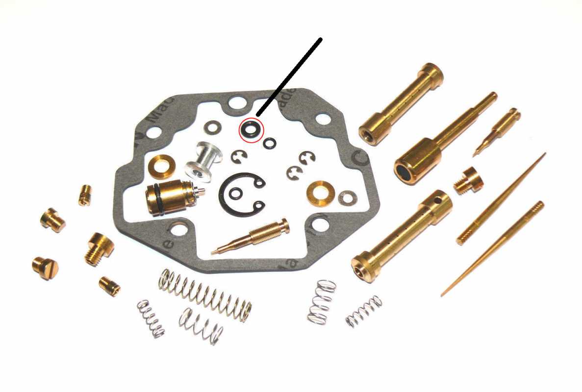

I am still coming to terms with this also. I started with 3 to 3-1/2 turns and since then I purchased a colortune to set the idle screws. According to the colortune they are now set at 1-3/4 to 2 turns for the blue butane color. I am still having problems getting it to idle nicely and it is currently a work in progress.
This is the carb kit I installed which was more or less the same as before except for the starter plunger (I installed the original starter plunger)
