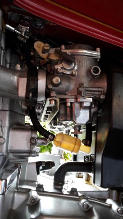

Herewith picture of my routing. Although it routes under the carbs to the T, I have had no problems with "vapour locks" and fuel starvation at high speed. I have a Pingel Hi Flow pet cock, 8mm fuel hose and a hi flow filter and have removed the electric solenoid valve as seen in the pic and never had a problem. On a recent rally in Zimbabwe I hammered the old girl for about 50km's at 190 - 210kph non stop, much to the amazement of others with no hassle or fuel starvation!

I noticed what appears to be a unique Drain-bolt on the left hand carb. Any chance of getting a better/close-up photo of this ?

Gotta agree with Craig. I've got a stock solenoid in place (what? I like 'em as stock as possible), with routing that's very nearly identical to the photo posted. While I do have issues starting it if it sits for an extended period of time (which I attribute to the solenoid), once she's going she'll run like stink. This includes several extended stints on the freeway as well, at a speed of at least 70 mph.
Now, I'm not saying that this routing is perfect- I'm just saying that eliminating kinks in the fuel line is more important than keeping the lines above the level of the carbs.
But, as always, to each his own. My bike is my bike, yours is yours. Modify it as you will.

One thing that is important is to be sure not to have air trapped in the filter, it will slow the flow especially when there isnt much fuel in the tank.
