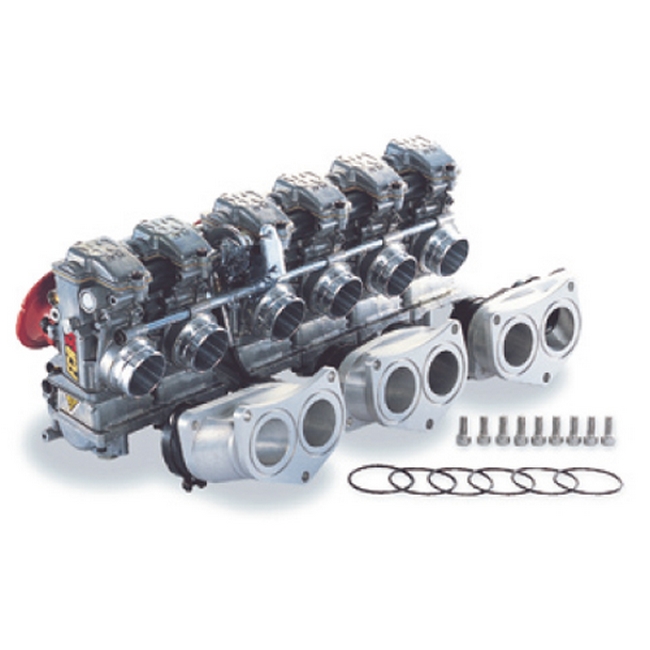

If you have the money...
Available with the adaptor manifolds straight from Japan.
japan.webike.net/products/21724102.html
Only like $3200.00 or so... :pinch:
