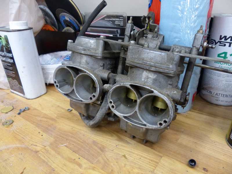

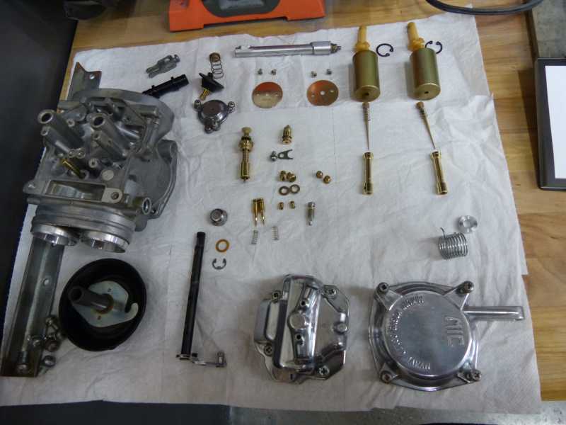

One carb cleaned and flow checked. Ready for assembling as soon as I get the O-rings and u cup seals.
From this
to this
From this
to this
