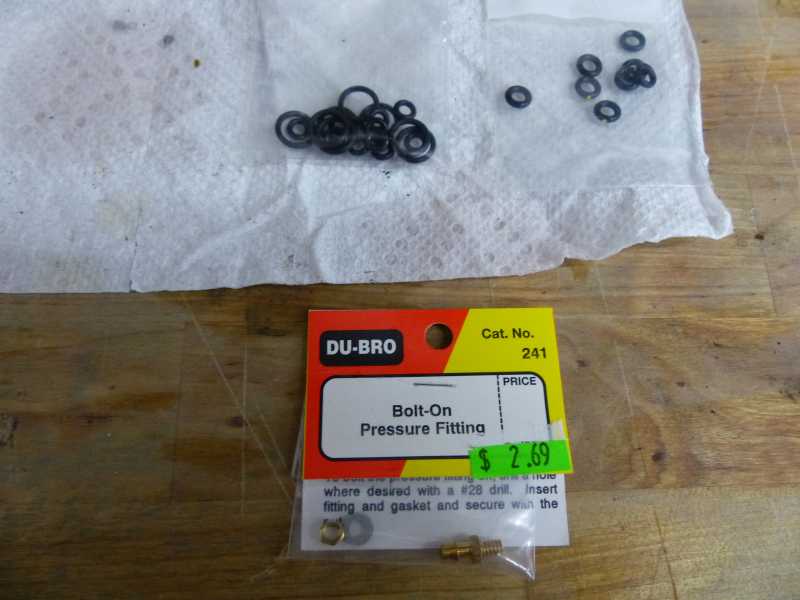

Went to Hitech Seals in Newmarket today and fitted up seals for the carbs. All seals are Viton 75 durometer.
[/Oring for the Neeedle Seat Body 7.5mm X 1.5mm Hitech part# MV8 150075 $1.39 each
Oring for Idle Air Needle 3.0mm X 1.5mm hitech part# MN7 15003 $0.75 each
Oring for carb bowl drain screw is a part #007 since there was no metric equivalent that fit correctly. cost $1.05 b]
I asked about the lip seal for the throttle shaft and they couldn't spec out a seal, so the search was on. Thank God for the internet. After about 2 hours of searching, I stumbled onto a website forum for the XS650 Yamaha and a thread on changing out the throttle shaft seals on their Mikuni BS34 carbs. Would you believe the throttle shaft and the carb shaft bores are identical AND the seals are still available YAMAHA part # 256-14997-00-00. Called up the local dealer and ordered 6 @ $5.95 each.
[/YAAHOOOOOOO!!!!!b]

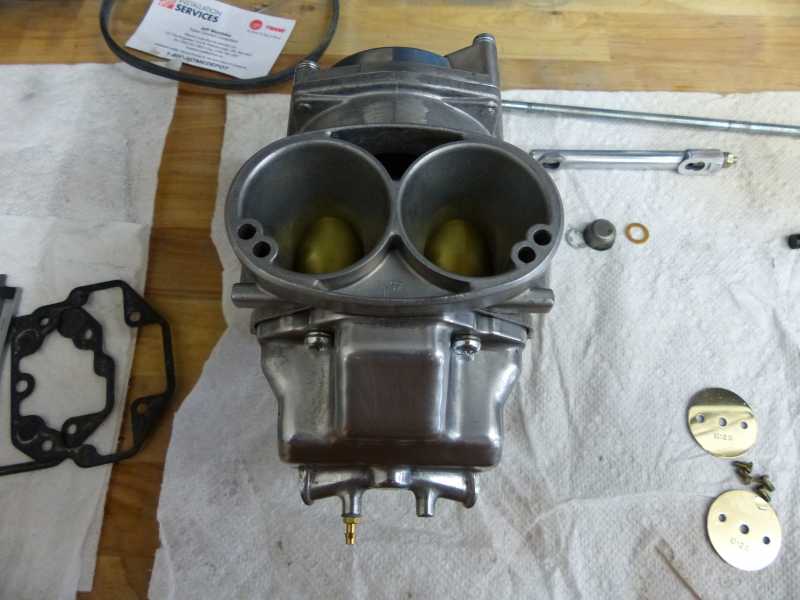

Here's a cute little mod for the drain fitting on the carb bowl. Go get yourself one of these from your model shop,
Drill (clean out) the drain fitting on the carb bowl with a #36 drill bit and tap with a #6-32 tap and install. VOILA!!
Now you can add a piece of 2mm tygon tubing for your wet float test. I'll make up a bracket to come off the side of the carb bowl screw and add the tygon tube. The bracket will have the 6.5mm-8.5mm markings on it. (soon to come)
