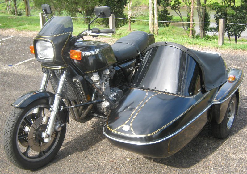

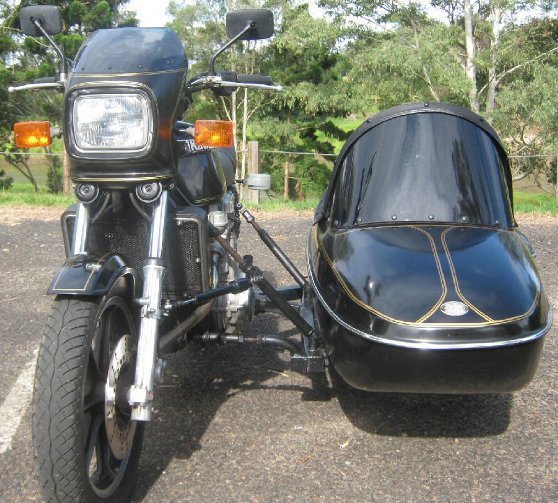

I've got a chair on mine, it's a DJP made in Australia in the mid 80's so sort of suits the bike, had the connections re-engineered a while ago as DJP used a lot of locking ball joints and they were always getting loose, it had a mini mag wheel on it and no brakes on the chair, used a VW steering damper on the front to steady the steering although it's not really needed, easy to disconnect from the bike, only a few bolts, connection clamps are left on the frame, I have to original manual that came with the sidecar explaining how to set it up with the lean and toe in, if you need a copy just for reference let me know. The DJP came either with a boot at the back with a lockable lid or one with a luggage rack on the back, mine is the latter, I only have the cover over the seat at present but also have the hoop and the higher cover with zip up windows, nice old chair, just thought i'd post a note, cheers Pete.
P.S. if you'd like some photos of the frame or connections I could lift it up and snap a couple
Oops forgot, your chair would be on the "wrong" side

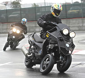

Here's a challenging thought for you. I often wondered why no one has ever mounted a sidecar on a parallelogram mount between the cycle and the sidecar giving full freedom of movement vertically between the two and also the ability to lean in either direction and the sidecar would lean as well.
I had an opportunity to go for a ride on a Piaggio 3 wheel scooter and what a scream to ride and watch the front end doing it's thing.

11 years 8 months agoI found a pair of Piaggio 500s for sale here in Bend a couple of years ago but passed when I heard that some had been experiencing durability problems with the front suspension mechanism. The 500s sold for better than $9,000.00 each. The used ones that I was considering were asking $6,700.00 for bikes with about 3K mi. on them.
