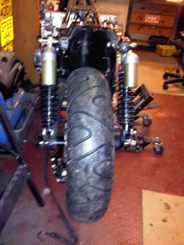

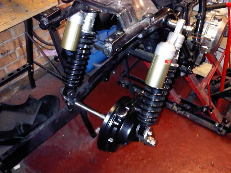

I wanted a larger rear tyre & to reduce the size of the front wheel to make it a little more sure footed into corners so fitted a Vmax diff which allowed me to fit an 3 spoke XJ900 Diversion rear wheel with a 160 section rear tyre. As the Vmax diff is on the other side of the bike, adjustments had to be made to fit it to other side of the Z1300 including swinging arm work & fitting the diff upside down. The bike is now 4 inches longer than standard. Then to make the back end really good I then fitted gas assisted ZRX1200R shocks. This can all be seen in the images below.

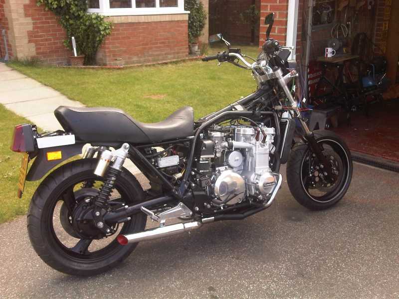

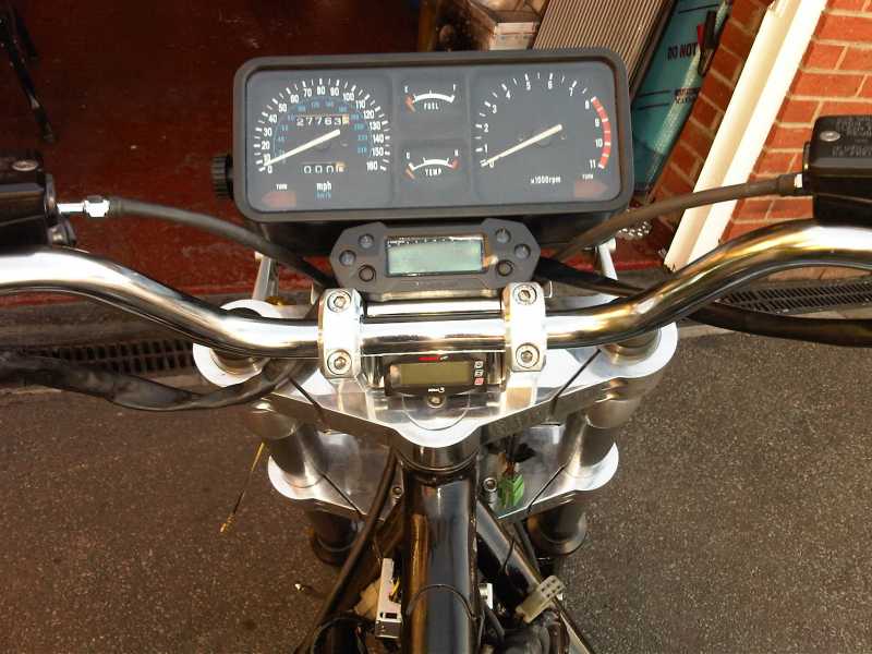

Finally it was time to make some subtle changes to the looks of the bike, so its fitted with a small digital instrument panel & digital speedo / tacho. The original clocks are still fitted but just for show as it would not look the same without them & I wanted to keep the classic looks of the bike. I have also fitted 1976 Z1000 High handlebars which are good for my back !

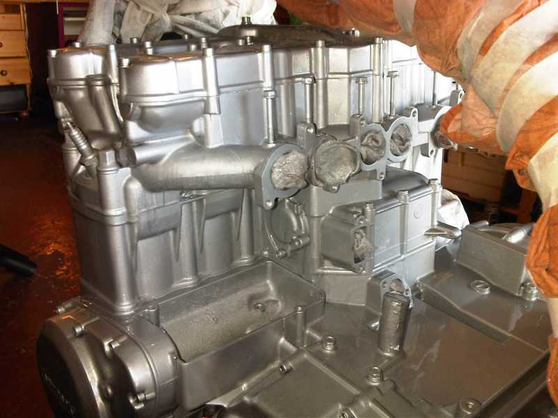

Engine fully stripped of old paint & resprayed in Smooth Hammerite.....the best

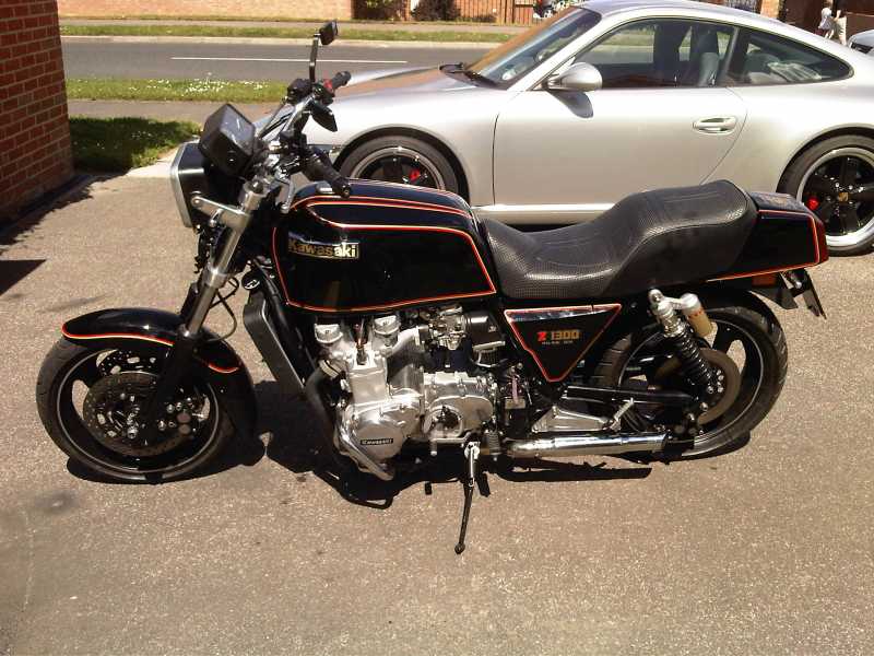

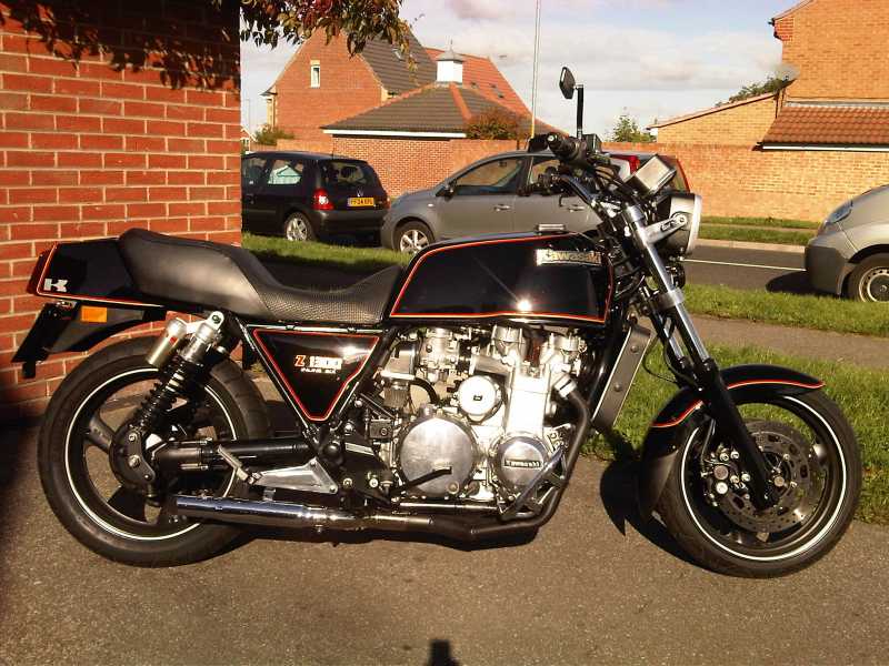

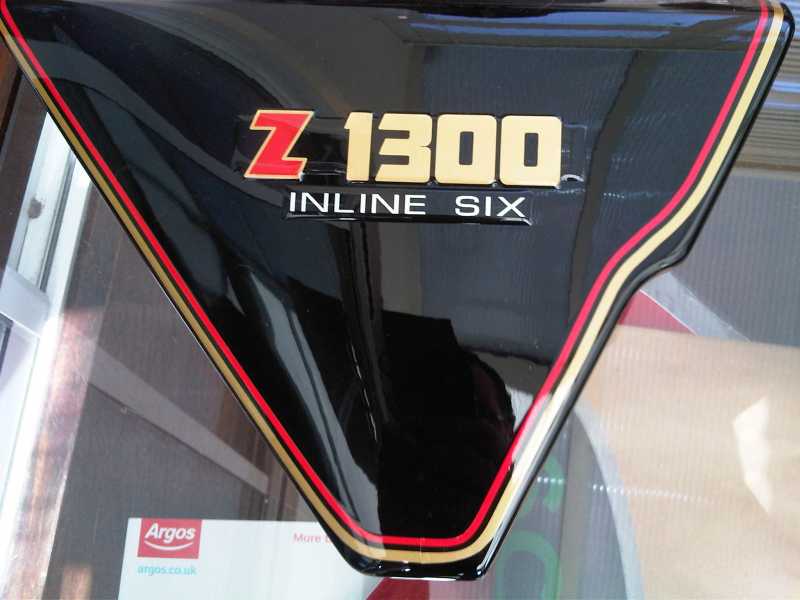

Finally it was finished in Z1300 A4 black paint with red & gold stripes & new graphics on the side panels & an Eddie Lawson Seat (short legs!).
The bikes starts, goes, stops & looks great in my own opinion. Its the Z1300 I always wanted.
