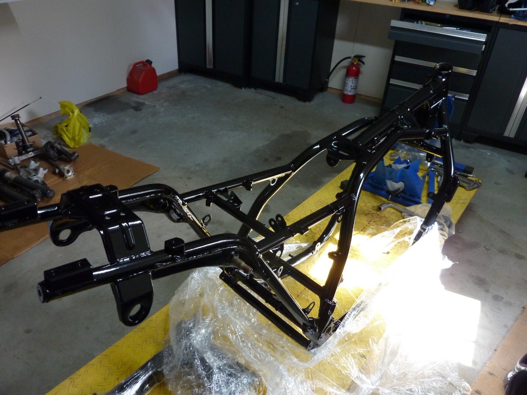

So getting started , I have a contradiction right from the get go - the powder coated frame.
The second - I couldn't get the swing-arm pivot / bearing off the main frame so I got a friend to do it .

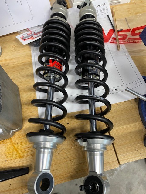

I have slowly been gathering parts . I ordered new rear shocks . YSS list a shock specifically for the Z 1300 . This set came from the Netherlands . The hole size for the top and bottom bushing is the wrong size . I have a support ticket open . No fix as yet .

I read your earlier post about the shocks not fitting . And your measurements for the top and bottom shock mount shaft is the same at 14mm.
The other KZ I fitted the YSS shocks on about 13 years ago had the same issue . But back then I had access to a friend with a milling machine and workshop , so he pushed out the original bushings and made me new ones the right size. It cost a few dollars .
For these new shocks- YSS got the basic's correct - that is -mine are 14.25 inches long which for me gives the bike the correct stance - and on your new shocks , you have about 1/2 inch of length adjustability. And just importantly, the spring rate for a 600lb bike appears to be correct. So I'm going to wait a bit longer for the seller to correct the bushing size problem. Mean while , looking on Amazon, or using the old oem bushings as mine still fit quite tight- if the outside diameter is correct.

3 weeks 4 hours ago - 3 weeks 4 hours agoI ran into a similar problem like this before and had new bushings machined up and pushed out the non-fitting ones for the new ones. Not a problem, just a pain in the ass. Better than sending the shocks back or waiting for the supplier to get new bushings made up and shipped.

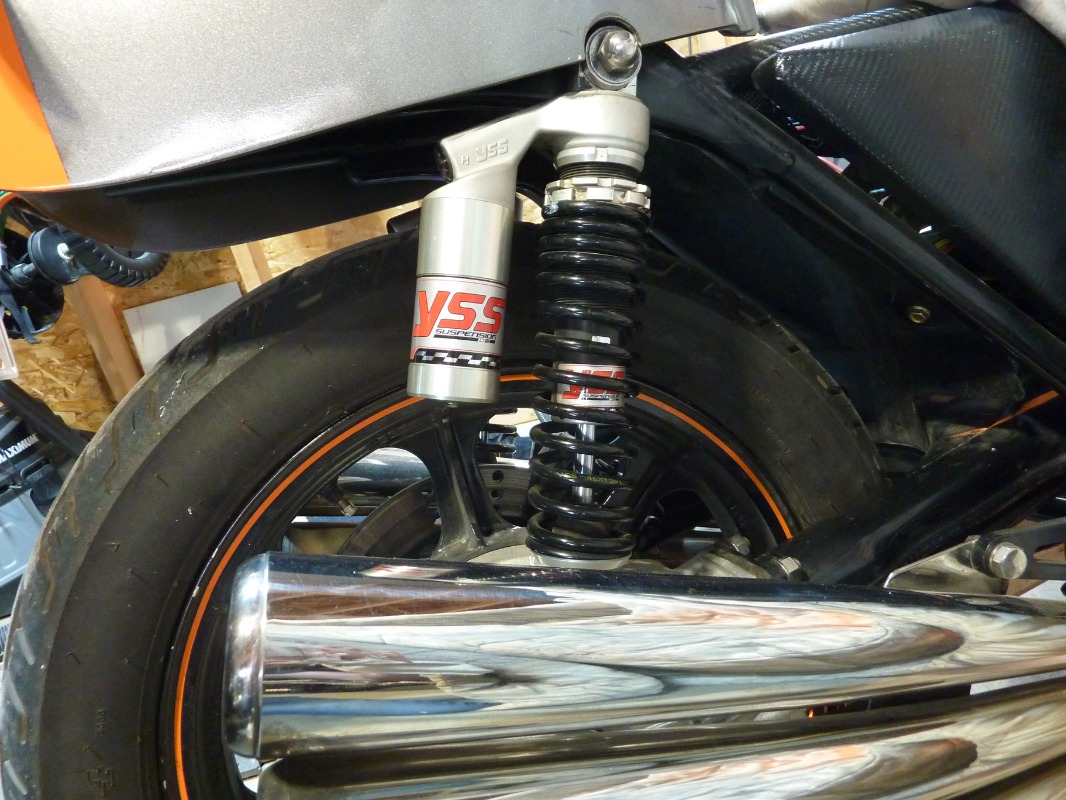

Those mufflers look sweet !! Can I mabye ask you to post a pic of them and what brand are they ?? They look like the mufflers from a Z900 RS ?? Also wondering what they sound like. I like to ride with a fairly quiet sound unless I dial it up and then I want to hear the bark, but for the most part I prefer a glass pack sound. I laugh my ass off when I see Harley riders put ear plugs in just to ride around and annoy everyone else.

2 weeks 4 days agoThe mufflers .The mufflers were made by Pipe masters In Australia around 2011. They are stainless steel. Peter made the pipes, bracket to join pipes together and a manifold adapter for each set of 3 as I used the stock header pipes - 3 into one and back to 3 each side that were high heat ceramic coated . They were very popular conversion for CBX owners , but Peter had a Z 1300 that he owned and had a picture of it on his home page , back in the day , so I asked him if he would make me a set. There were a few sets sent to Europe the Z1300 , but my set are the only ones sent to N.America as far as I know. Pipemasters have a Facebook but it's hard to tell if they are still operating. There's also a video , the camera is mounted at foot peg level and facing backwards - gives a good idea of sound on the CBX . The Kawasaki , having the bigger engine - sound is deeper
