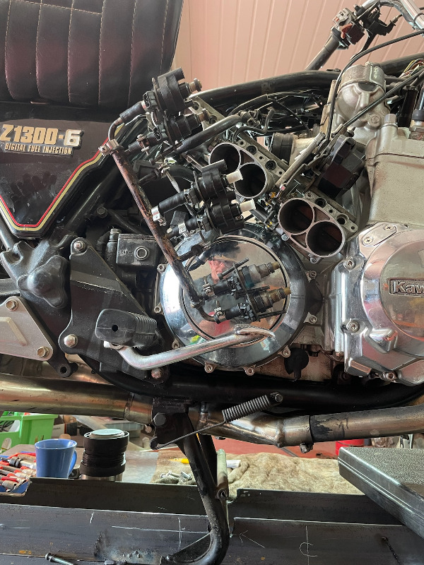

Previously I tested the injectors by extending the fuel line and running them off the bike and just observed the spray pattern.

Fuel injectors were leaking and drowning the plugs on startup.
Extra smoke was from un burnt fuel in the pipes.
Also causes earsplitting backfires, went from 100mph to wont start, overnight!
