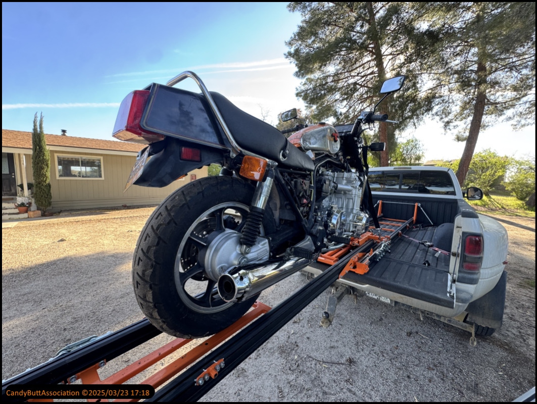

  1. =14pxReplace front brake lever
  2. =14pxFlush front MC, bleed. Very grody and dry too. But just enough fluid in lines to enable front brake action. Bled.. noticed that MC has no air bubble from either little hole. Put small screwdriver in RHS hole, some small bubbles. Leading to:
  3. =14pxPulled both calibers. Pistons may be moving, but not by very much. Should probably buy master cylinder kit and new pistons and seals for the calipers.
  4. =14pxLubed clutch cable. Inspected other end throw out mechanism.
  5. =14pxLubed clutch lever pivot.
  6. =14pxWill vinegar hurt the fuel tank level sensor?
  7. =14pxUnfroze petcock
  8. She got a bath

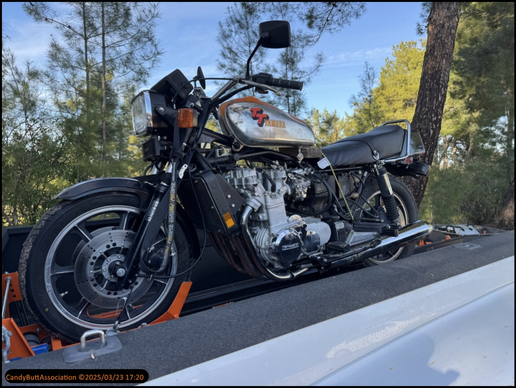

Yesterday broke out the Gunk and pressure washer...

I like the tank.  Not.  But you can't go wrong for $500.

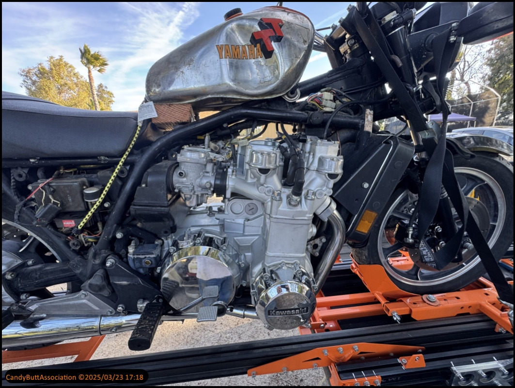

I have the stock tank, it needs to be vinegar coated to remove some light rust. The TT Yamaha tank is just to start and move the bike off and on the lift..
