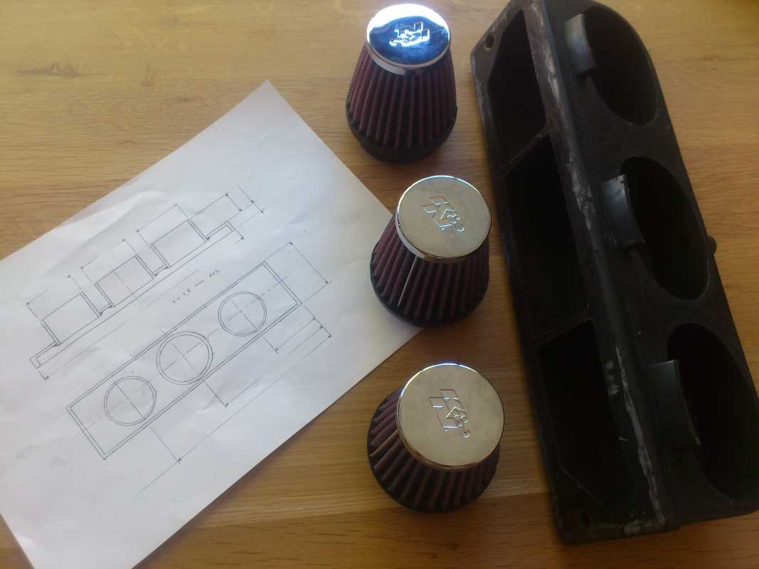

Well, I didn't take it on my holiday, because I didn't get to ride it as much as I wanted before taking it for such a big ride.
It drives ok for now, but I do have some plug fouling from time to time..
going to put on a modified spare airbox and an exhaust with higher flow, and than see if I can get it all set up just right!
filters just came in.. He doesn't know it yet, but my big brother is going to weld me a nice stainless bracket for them.
