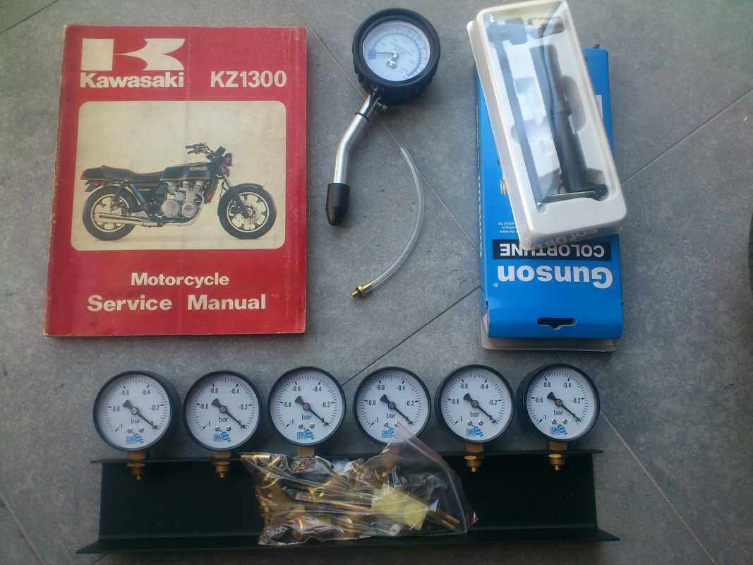

Hope this helps, I will post how things go and any input is much appreciated..

ADA Boy!! Make up your own vacuum gauge set. I have 6 gauges and needle valves to make up my set as well. The only thing I would suggest before you start using them is to hook all the gauges up to 1 port and check the gauges against each other for calibration. They're not expensive gauges so they may be out and the best point to check the calibration is mid position on the gauge, so it looks like your gauges are in barometric pressure (bar) so calibrate at .5 bar. If you have to install a bleed valve in the vacuum line so you can get a .5 bar or there abouts supply.

it's actualy a complete 6 gauge vacuum set I bought here in holland, with gauges, hoses, valves and adapters.
So they should be calibrated, but I will keep in mind to see if they are.
