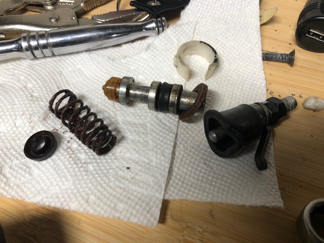

The rear brake master cylinder on my 1979 A model. This bike is an early bike - in the first 1000 built.

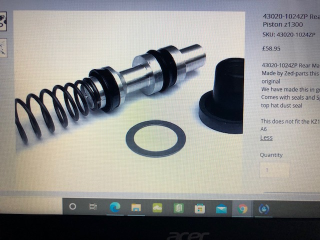

The piston in the m/c may need some new parts so I started looking at the german shop and Zed-Parts and both show essentially by photo, the same part.
But the new part is quite different from my old part - especially the plastic piece at the top.
Any ideas.

My bike had sat for 32 years, but I just cleaned up the master cylinder (as well as all the other parts) and it works perfect.
