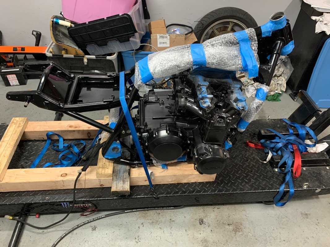

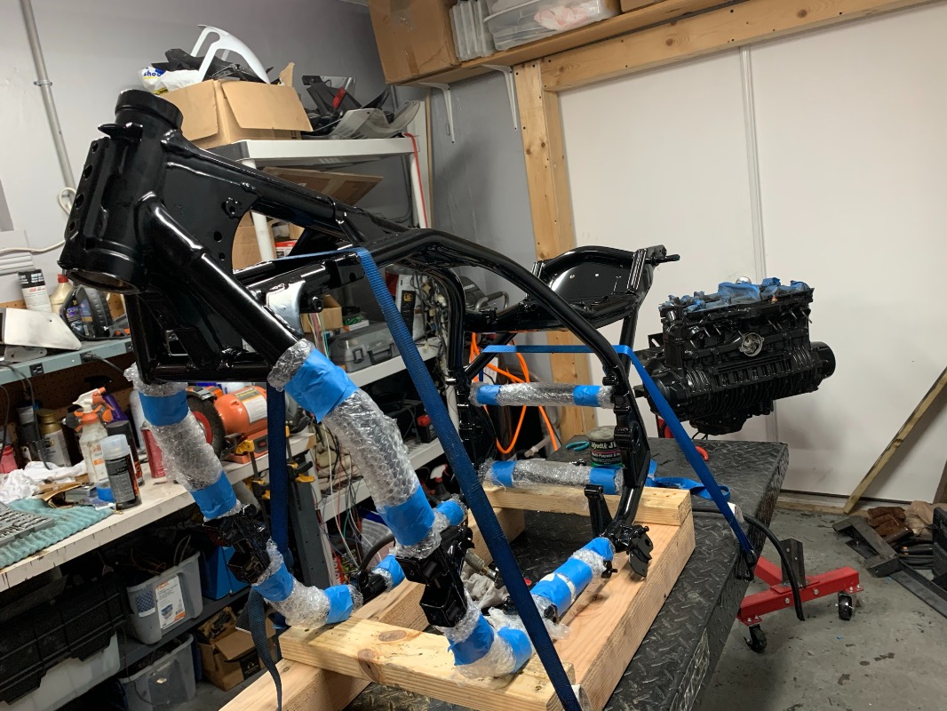

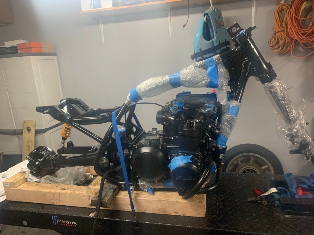

the engine is back in the frame
front end installed
swing arm installed
so far all is going good with no issues
it is time consuming as i need to tap all threads
the only issue now if to fined tires...

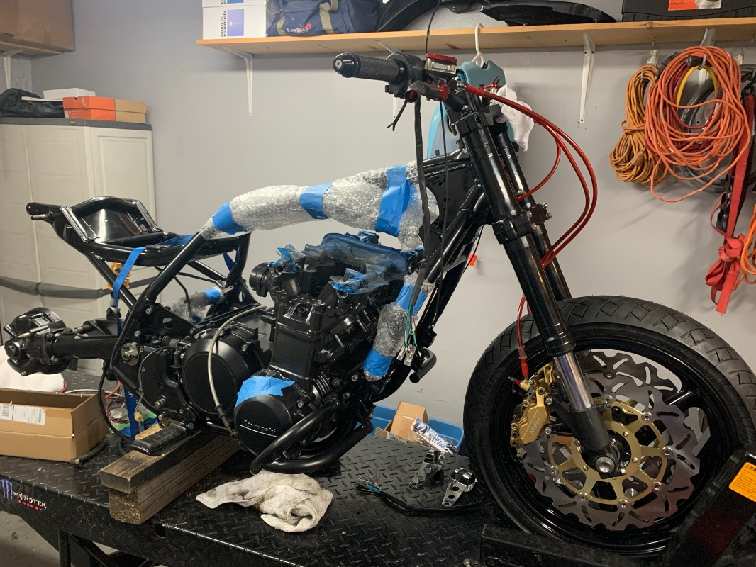

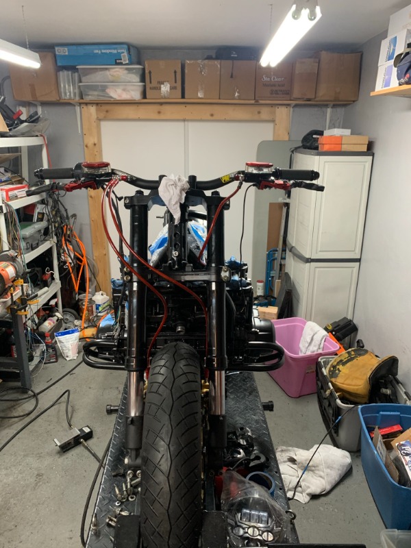

5 years 11 months ago
Slowly making progress

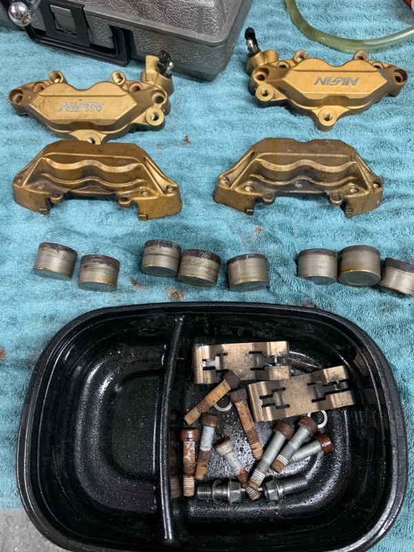

Front calipers rebuild

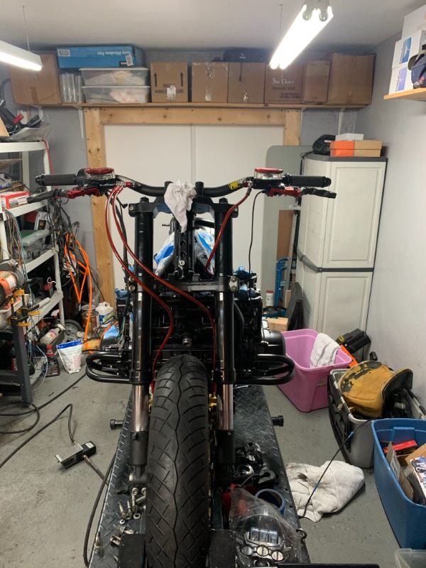

front wheel and new front brakes installed
received rear tire yesterday
hope to have rolling bike by the weekend

- Posts: 974
Well done. It’s looking really good. The fork and brakes are very impressive. The levers and master cylinders look interesting. It looks like you’ve converted to a hydraulic clutch too.

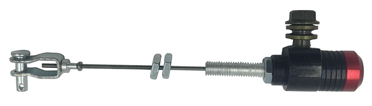

Which method did you use to convert to a hydraulic clutch at the engine end Bar? Looking very good btw
thank you guys
I didn't start the electricity yet.... that will be a challenge
but i made sure all is working before I took it apart, so in theory I should be OK
for the clutch conversion I used the part below, this is the easiest way to go and fit as direct replacement on most bikes
I used the same on my CBR and working great for few years
