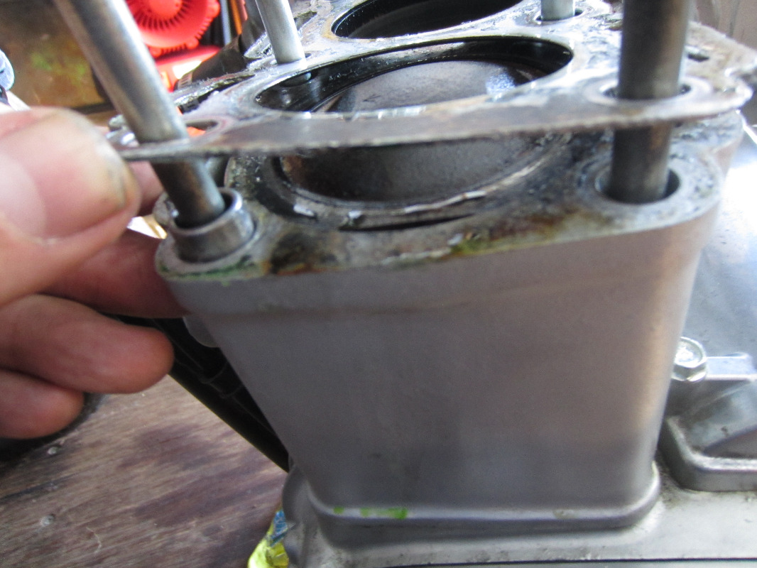

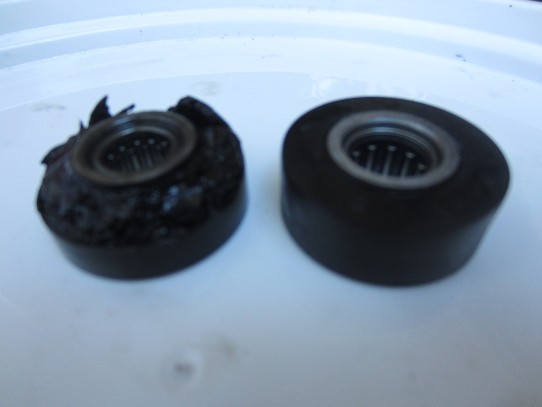

So… the head had to come off and once removed, I was able to confirm that the head gasket was leaking and that the lower rubber cam chain idler wheel was partially shredded (another possible candidate for the intermittent, abnormal engine noise, I thought).
It looked to me like the PO had previously fitted an accessory brand head gasket (without the sealant rings) and it didn’t look like he used sealant around the water jacket ports or (anywhere else).

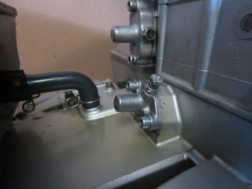

Now, I was also able to easily adjust the tension on the manual cam chain adjuster, screw in until light contact, then back off a quarter turn…
I know… people tell me that the proper way is to adjust them is with the motor running, I did try it but could not find any sweet spot – it all seemed the same to me.

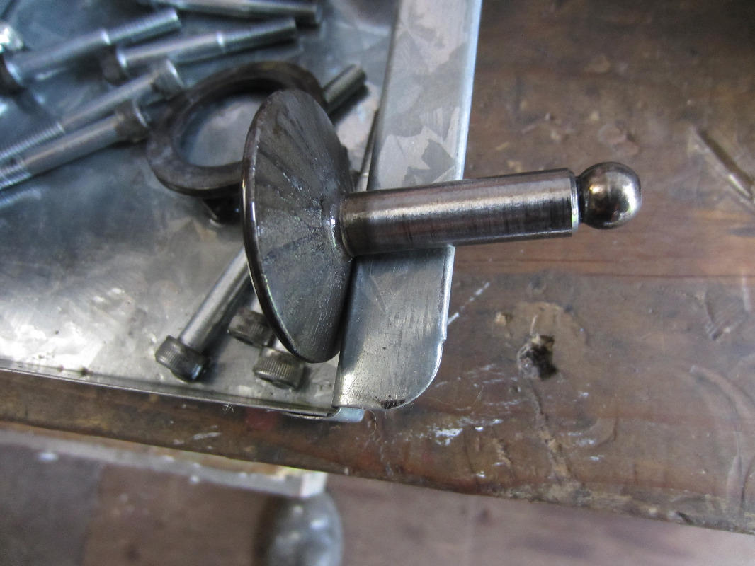

OK, so I dug out an old OEM auto tensioner (the type that fail), checked that the spring was within spec (min, 71mm long), installed it, released the mechanism, turned the motor over several times slowly and then made the same measurement – I was surprised that it was very similar.
With an addition of a longer 6mm bolt and lock nut, the OEM tensioner can be made into a manual locking type of adjuster with the advantage that (periodically), when you release the lock nut and bolt, you get the factory chain slack adjustment (no chance of premature wear on the chain, idler gear or roller)
This has previously been well documented in the Com, I am thinking about leaving it in and giving it a go…

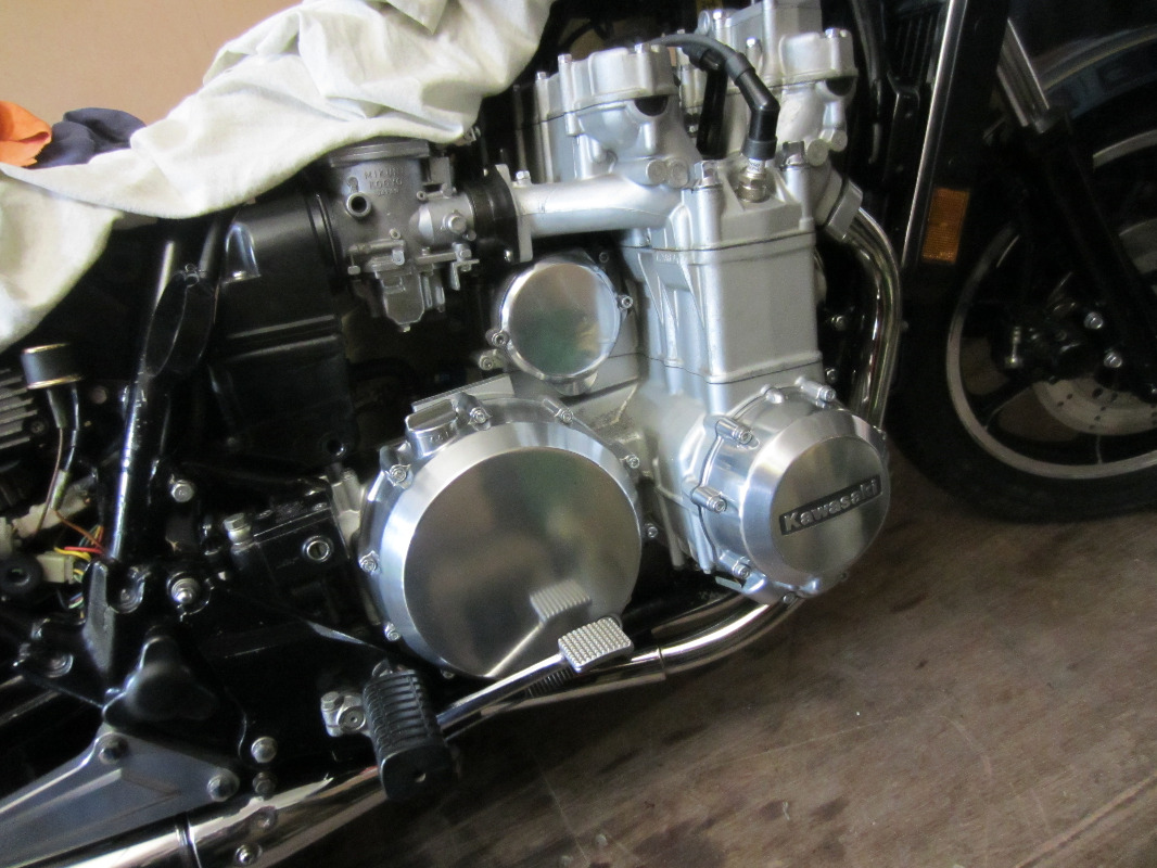

When I removed the clutch cover to clean and check the status of the plates and polish the cover, I found that the clutch mushroom was friction welded to the ball, it turns out that these parts have the same part number as used on the Z1 series from 1972 – to at least 1979 and after rummaging through some old parts bins, came up with the required replacement parts without leaving home.
It’s a pity that the clutch plates aren’t the same as well, because mine are just about on the service limit
I went for the satin over the mirror finish on the covers, this is #200-ish paper applied wet with kero and then hand polished with autosol.
