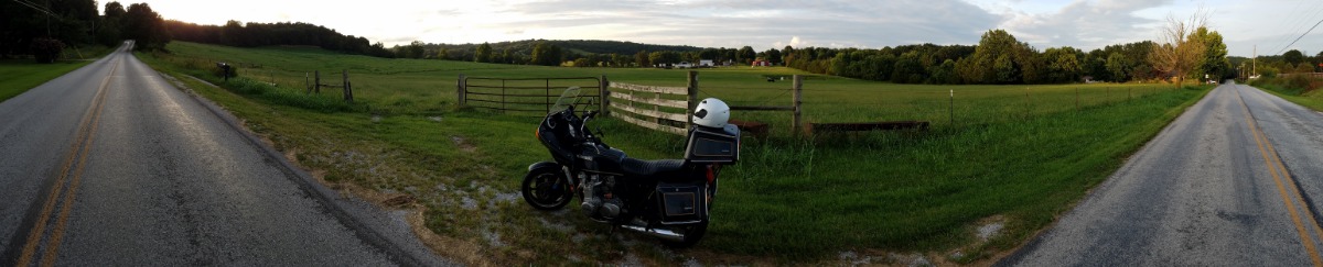

With the girls in school I was able to slap her together and head on out for a short ride. Losing coolant from front of the block under the water pump. Not fast enough for me to worry about right now since pulling the engine and replacing the gaskets is not happening until winter or spring or summer.
