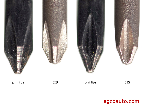

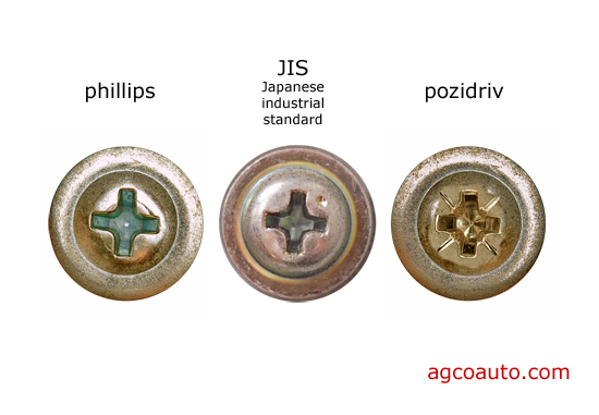

You're going to get frustrated if you don't "stop the bus" and go and find yourself a set of Japanese Industrial Standard drivers to properly fit in to the JIS Philips like screws. When you know what you're looking for there are easy to find. The driver bits you linked in the last post have PH2 and PH3 which is Phillips 2 and #3 bits and they don't fit a JIS screw .
All JIS screws have a tiny dot punched in their heads to indicate JIS screws. Easy to see when you look for it.
