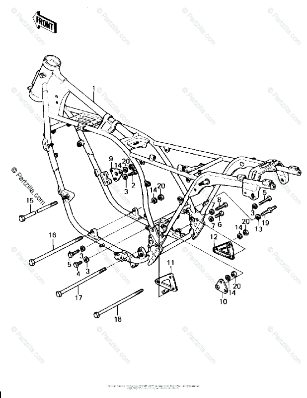

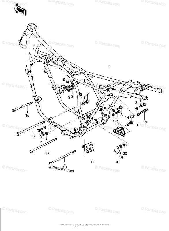

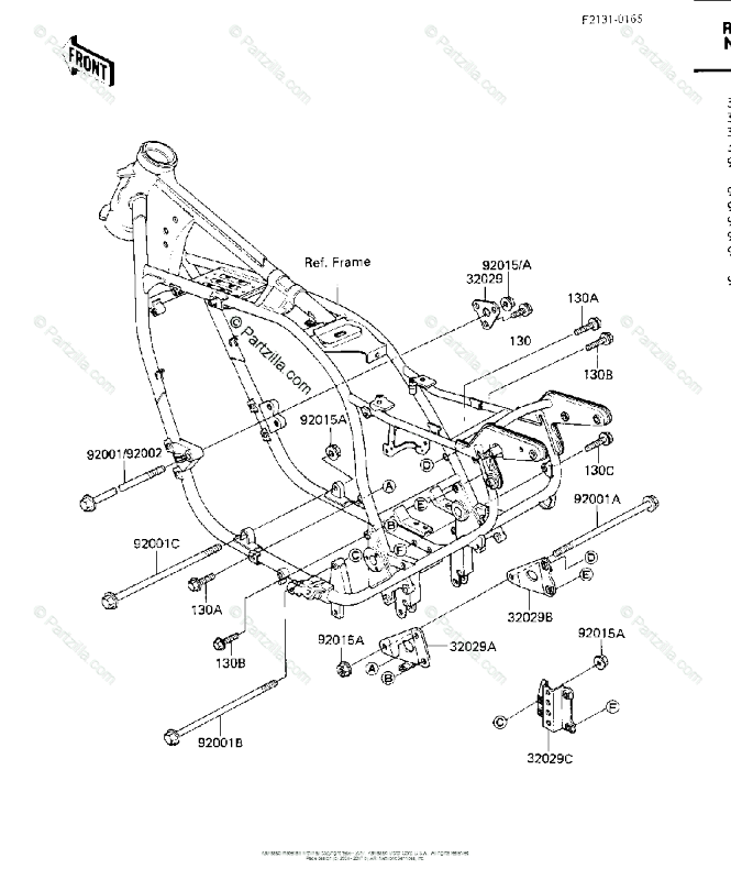

Voyagers (ZN1300) have a frame that is significantly different than a KZ. You can tell some of the differences from the part diagrams and others by looking at the bikes.

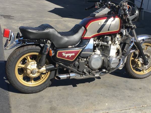

Here is a stripped down Voyager that is for sale:
sfbay.craigslist.org/pen/mcy/d/naked-kaw...1300/6747419149.html
The most noticeable differences (for me), are the lower seat height, the different shape of the frame around the side covers and the shorter tail.
Build which ever you are happier with...
I don't see a location in your profile. There are a couple of KZs for sale, not sure how close any are to you. There is a list in the for sale forum section.
