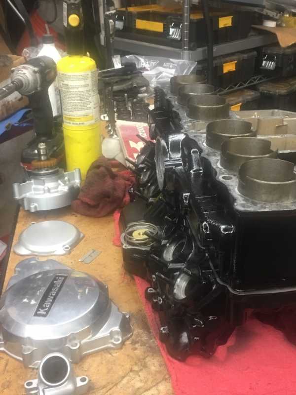

Looking good Frank!
I wonder what paint did you use. Looks shiny.
The valves in the back, are they new or are you going to re-use them? And did you machine the seats or just lapped the valves?

I cleaned all the valves and lapped them. I had planned on putting in new valves but these, the seats and the guides are all good.
The exhaust side had heavy carbon build up. Worst I’ve seen since a motor I was into in 1981. Had to chuck the valves up in the lathe. Used paint remover and pressure washer to clean the ports.
Have valve seals and springs on their way.
I ground down the more visible casting marks on head & cylinder, then used VHT engine paint and VHT engine gloss clear.

The exhaust valves where a PITA to remove the black areas from the sealing surfaces, but they did all 6 clean up with one small piece of scotch bright (1/3 of a pad). So the "pitting" could not have been more than a thou as you really can't remove any significant amount of metal with a scotch bright pad.
The valve seats show no pitting on the sealing surface after I lapped them. And I did not go at it hard. I have one of those lapping tools that goes in a drill (it oscillates). I hit it for a second, pull it back, turn the drill 1/4 turn and hit it again for a second, repeat. Probably did 10 seconds with medium compound and 10 with fine.
If you look at the KZ1300 book it has a drawing of what to look for in the contact patch. Mine looks just like the "good" view.
I just got lucky that it was done properly last time around.
I got this as a basket case because the previous owner had no compression on #3 (like 20psi). Rest of the cylinders were good. Oil pressure was good. Owner and his mechanic buddy disassembled to put new rings in it, but then could not figure out how to put it back together.
My best guess is the valves had not been shimmed in a long time (or not correctly). I have seen no issue with the pistons/cylinders/head. I should find out for sure when my springs/seals show up, as I've not done anything that should appreciably change the valve clearances.
The previous owner had bought the bike used. This KZ1300 was his FIRST MOTORCYCLE. So I'll bet he did not/does not understand the need for adjusting the valves.
